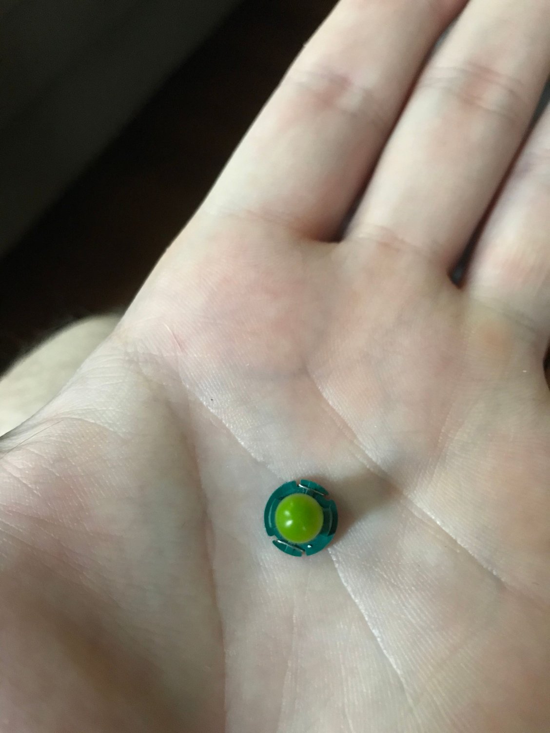

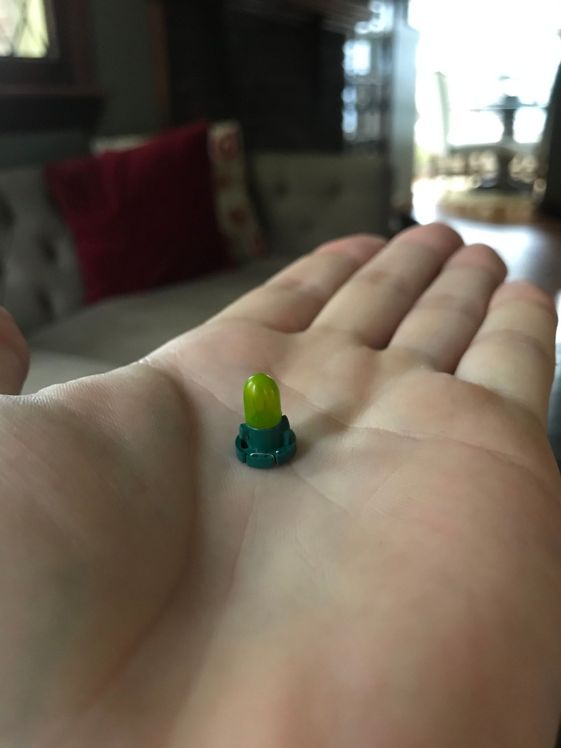

I have been driving a 2012 Scion iQ for years now and the light in the climate control ****, specifically the fan intensity ****, just went out. I have not had great experiences with
the Toyota dealer down the road from my house and have been doing all my own maintenance pretty much since I bought this little guy. I, for the life of me, cannot figure out how to find this light bulb.
Attached are pictures of the bulb...Any ideas?

I suppose it is too late, but I think this one should work:
90010-01122
Generally speaking, any interior light bulb of a similar size should work - just replace the base and the cover. I've transplanted a Honda Odyssey I had laying around.
