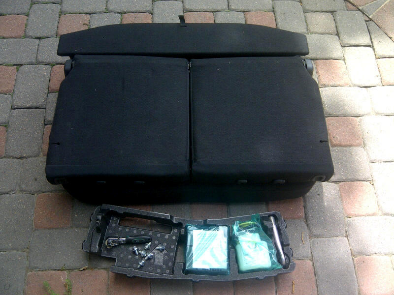

OK, if you are not 18 and want to remove your IQ's rear seats here is how I did it.
First, some background, I bought the IQ to use for courier work so the extra space is valuable to me.
1: Remove the storage box and take out the emergency kit polystyrene tray. That exposes the rear 4 bolts you need to remove. Use a 12mm socket/wrench.
2: Slide Pax seat forward and maybe even drivers to give your self some room. Then lift each front corner firmly until it pops out of snap in clasp.
3: Remove one of the panels in what should be the first picture below right behind the drink holders. You only need to remove one I removed the one on Pax side. Use a flat head screwdriver to pop it out it has foam on the back so getting it out isn't necessarily smooth and easy but not difficult either! This will let you:
4: Pull that side of the seat forward (the backs have to be released="down") it will now come forward enough so you can now go to open hatch and lift the other side up and bring the whole unit out (yes, in one piece!) be careful about the bolt mounts on the hinge so they don't scrape your plastic interior.
5: You have the option to remove the U mounts that the seat backs latched into. Using that flat head screwdriver again pop of the panel that they come through and you will see the bolt you need to remove to get them off!
I am attaching pics of the panel that you need to remove before and after. The cargo space after seat removal (note: the white tabs are where the seat front clips into place) and a pic of the seat, storage box and emergency kit with the bolts and 12mm socket wrench I used to get it out!
That should be helpful I hope!
2: slide Pax seat forward and maybe even drivers to give your self some room. Then lift each front corner firmly until it pops out of snap in clasp.
4: Pull that side of the seat forward (the backs have to be released="down") it will now come forward enough so you can now go to open hatch and lift the other side up and bring the whole unit out (yes, in one piece!) be carful about the bolt mounts on the hinge so they don't scrape your plastic interior.
Peace,
~Phil Phree
Great instructions Thank you
