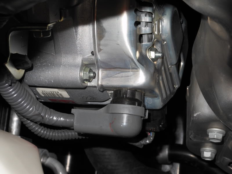

Here are pictures of the stock wire connections...
The alternator...

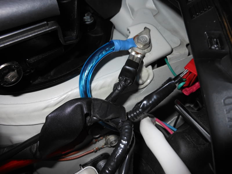

The body ground...

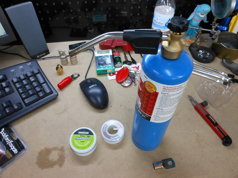

Some of the tools required to solder the new 0 gauge connectors to the wires...
