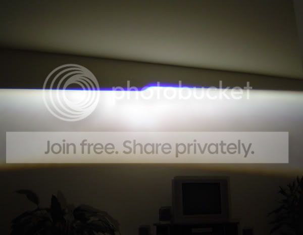

oh pics of the cutoff with a clear lense (borrowed from hidplanet.com)
