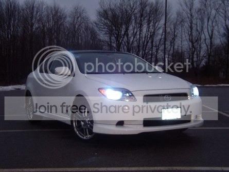

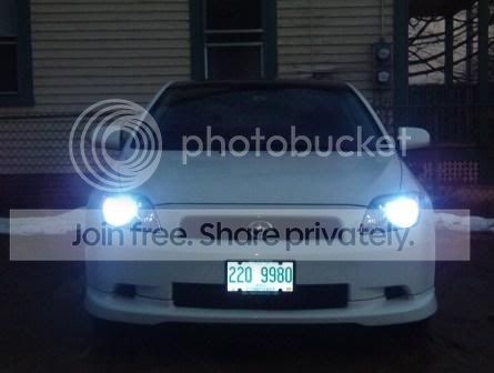

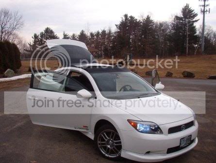

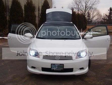

I have this 10,000K HIDs for about two month, and I like them a lot! They are wicked bright that ppl flash at me sometimes, but they are way better than stock. Its technically illegal, but i havent get pulled over for having those yet.
tell me what u guys think

super nice,
price and how was installation?

I like your HID setup a lot....how much did you pay for them and where did you get them....list any URL's that may be helpful....Ive been wanting to buy HID's

THANKS GUYS....
i did not do the installation, but the guy said that he didnt have any problems..its plug-and-play system
ballasts are mounted with brackets, so there is no worries that they can accidently fall off
i bought them on eBay....just make sure they have warranty. Mine are called Extreme lightning system, similar to McCulloch, just a bit cheaper, i got them for about $250 i think, and i paid $75 for install, not bad.

holy hell...can you see the road at night? $75 for a 15minute job is what...$300/hr!! the installer shouldn't have a problem plugging the hid straight into you 9006 sockets...you probably will tho when the sockets and wiring melt...

Take a pic at night from inside the car up against a garage also take a pic from inside the car looking down the road..
Looks nice so far..

It's never a good sign when people start flashing you because your lights are too bright...

why are u saying they will fry my wires since HIds consume less power? how long whould u guess its gonna take before that can happen?
and i will adjust the bolt hopefully it will help to eliminate some glare. ALso, do they have projectors for tC yet, or they still working on it. I have heard Umnitza is in a process of making those.

after it warms up, the hid ballasts do draw less at 35w compared to the 55w of the 9006. but the startup process, where the bulbs blink and flicker and does a pretty dance with blue and purple colors, thats when they draw around 1.5 time the normal current. its this excessive current that kills your stock wiring and harness over time. buy a relay harness that draws power directly from the battery for $30-40 or make one yourself for $15. either way its cheap insurance.
there'll be people that'll tell you "i've had a plug and play kit for so and so months or years w/o a problem so STFU!" sure, your wiring and harness may not melt tomorrow, or next week or two weeks from next year, but when it does, you'll wish you spent the bucks on the relay instead of paying to fix the mess due to negligence.
