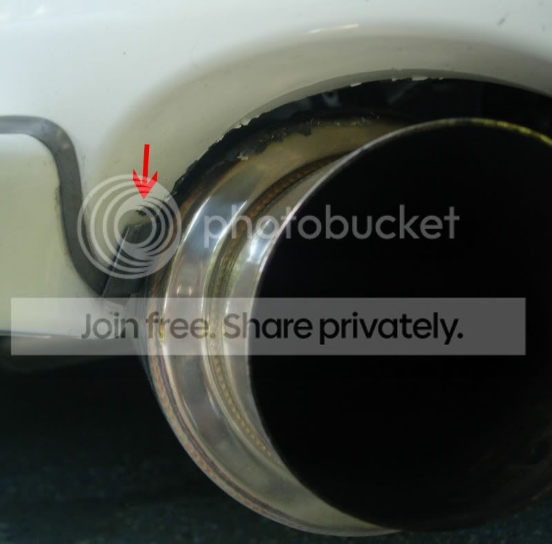

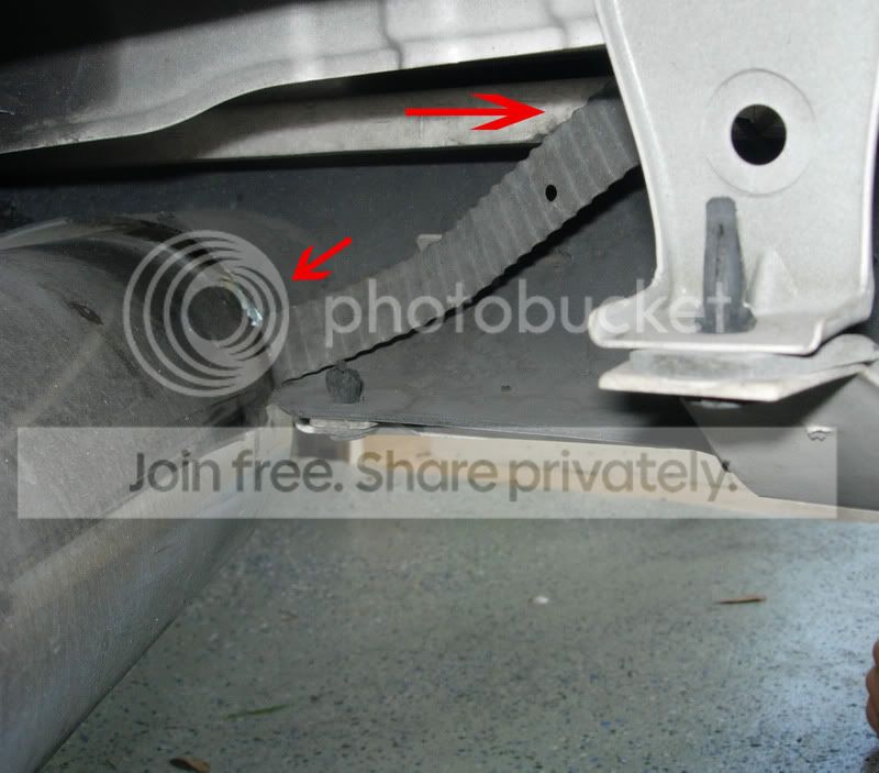

OK here is my little bracket to protect from melting my bumper.
just a thin long piece of bendable steel, bolted into a part of the bumper safely and secure. then bent the other end to fit around the lip and set the exhaust just away from the bumper. this is SIMPLE, and FREE if you find the steel.
it can NOT be seen unless you get on hands and knees to look at exhaust.
any questions...let me know.
1st. the outside shot. you can see the steel bend around the corner and set the exhaust off the plastic.
2nd...from under the bumper. you see the exhaust on the left and the long steel bracket goin from the exhaust section to under the back bumper
