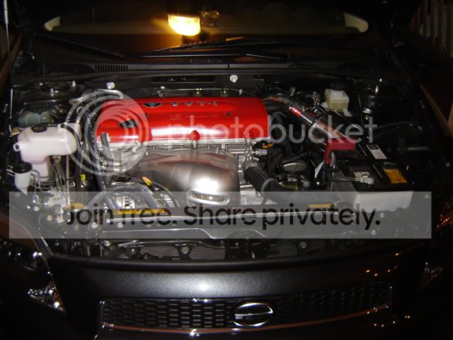

Old Jul 1, 2005 | 01:58 PM
zac's Avatar
zac
Posts: 371
[img]
[/img]
heres mine i didnt sand at all for fear of scratches, it has not peeled or chipped at all.
just use any kind of masking tape do not use very strong sticking tape, because the silver color on the letters could come off when removing the tape, use an x-acto knife very slowly to remove any edges of tape that are not needed for the covering purposes.
test the paint color on the underneath side FIRST, to make sure it is the hue you want as it will come out a little darker than you plan.
