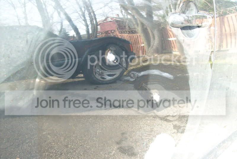

hey everyone. a few months back I posted a question. Asking if anyone had any bodywork tips for 2 dents I had on my driver side door. Well I got a lot of negative responses. telling me I should take it to a body shop, I'll mess it up if I do it my self. and so on.
Well I did my homework read some books, saw a lot of vids and asked some close friends questions. Well this past weekend the weather was good so I spent Saturday afternoon fixing up the two dents. and I have to say that was pretty easy fix. I still have to repray the top coat, It has been to cold for me to do that. but the thing that bothered me the most is gone. those damn dents.
I was quoted from body shops between 500 to 700 $ and not having my car for week. Well it coast me a total of 40 $. I guess I'm one of those guys that feels if I can do it myself, why pay someone else to do it.
here are some pix
this is what the dents looked like.

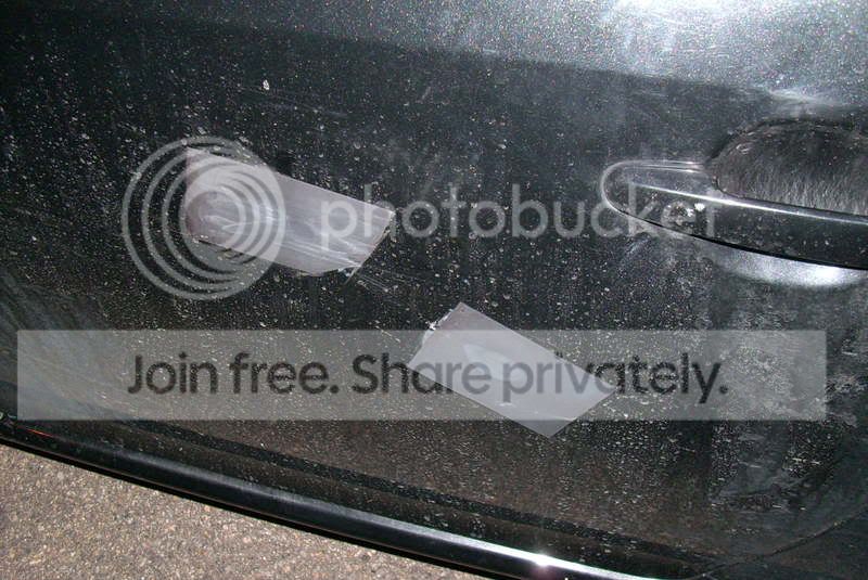

after as cleaned and sanded the area, then re cleaned the area I applyed the body filler. this is a shot between the 1st and 2nd layer. I was using every thing layers

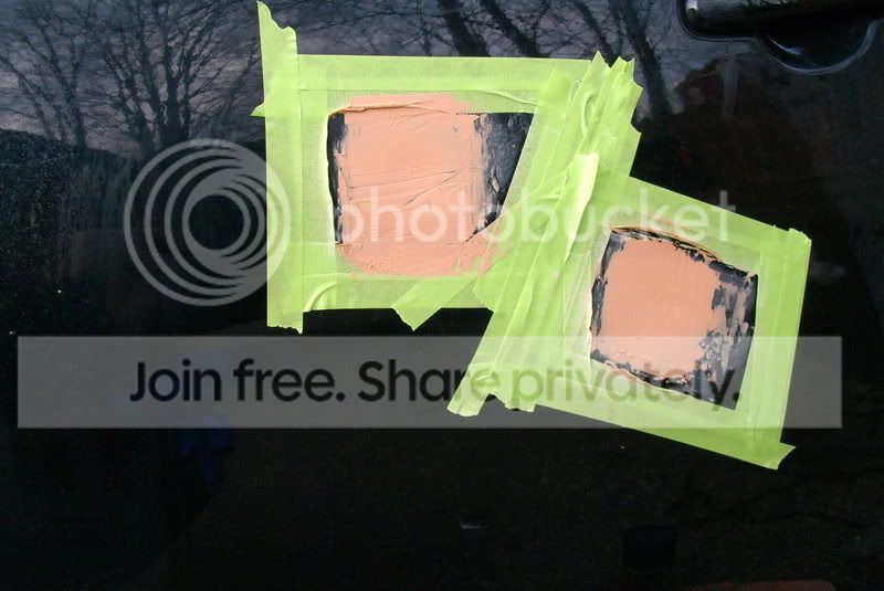

this is a shot of 2nd to last layer. I used black primer to help find the low and high spots..
