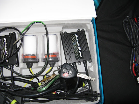

I ordered H11's 6000K last Thursday with the scionlife discount and they came in the mail today. unfortunately checked the mail a little to late and i have to work tonight so they'll be going on tonight after work or tomorrow. and will post pics, haven't seen to many 08+ hid conversion pics.
does anyone have any suggestions or pointers i would need to know when installing them (ie where to put the ballasts)

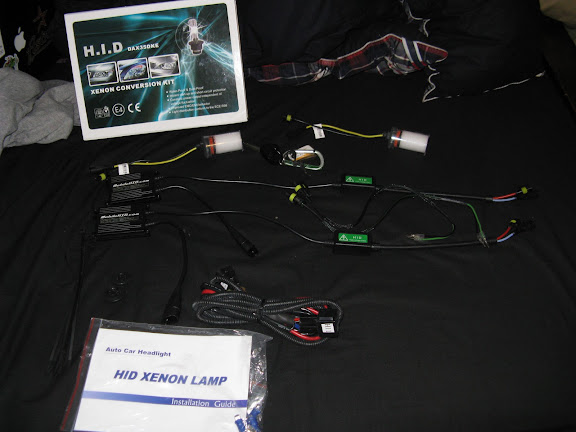

They seem to have made new ballast as they seem smaller than in the pics on the website, they also came with some freebies it seems, some led wedge bulbs i dont know what color they are yet im assuming white

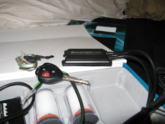

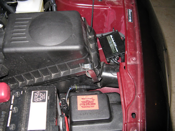

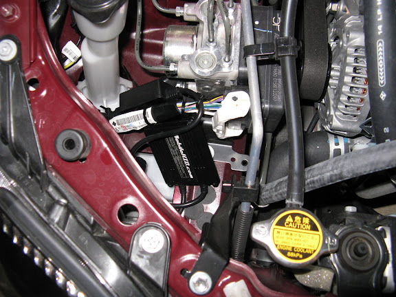

Heres where i ended up put the ballats with zipties, if anyone knows of a better place to put them this is only slightly temporary

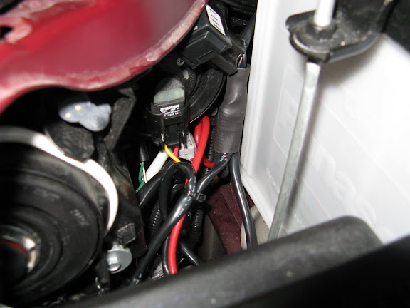

heres the relay (littlebox with h11 on it) i think really need a better location for it bc it isnt water proof, and i put the ground wire to battery, anyone know of a better ground spot ( i was thinking same as the fogs but i would have to go under the car for that)

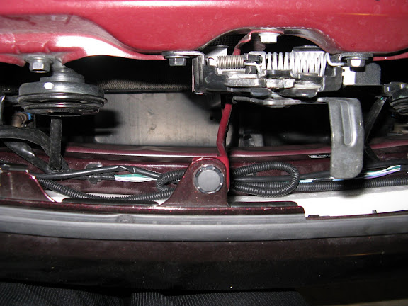

wires along the bumper

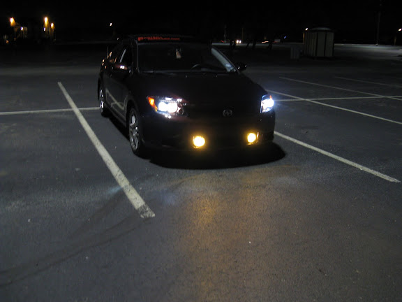

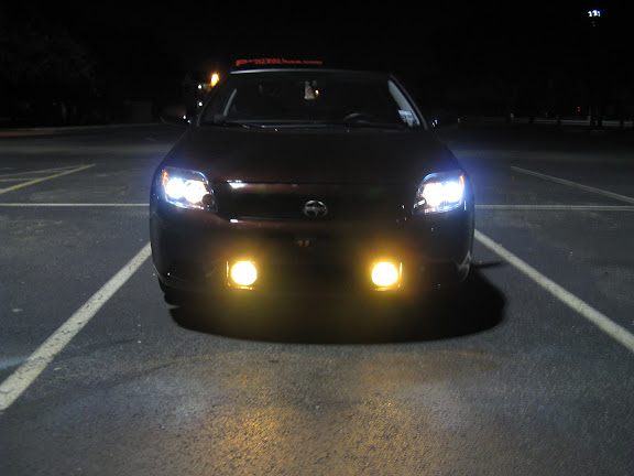

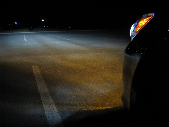

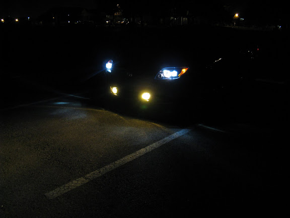

heres out it turned out

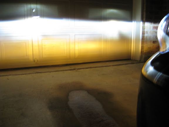

probably need to lower them some but it doesnt seem that bad

Those ballasts are smaller than mine.
same here .. i think those are the new digital ones as they call them. correct me if im wrong.

Mobile HID is one of the easiest kits to install......pull your bulbs and put the new ones in......run the harness across the gap between the bumper and the radiator......there is aharnes already there that you can zip tie it to.....pull harnes up to area by light and plug in and hook up wire on light to ballast......hook up relay to battery and then hook plug harness to the drivers side light stock wire location and turn on lights........tidy up the wires with zip ties.
did the ballast come with hangers......look under the packing crate in the box.......if not I do not know where would be good to mount as mine are hanging off my radiator bar on each side of the grille.

im open to opinions about the height of the headlights (or foglights) seems ok to me but then again i dont know what normal is, first time with hids

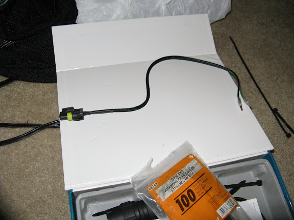

anyone have any idea what this is for?

what do you want more pics of.
the pic above is basically some kind of harness with the plug that goes in the a oe headlightbulb with a black and green wire on the other end

u say u've never seen an 08 with hid's???? where have u been lol
and that color combo looks great, i wish i had gotteb 8000k. and why are your keys in the first couple pics lol
and are those bulbs or overlays in the fogs? and yeah the right headlight should be higher not the left,
