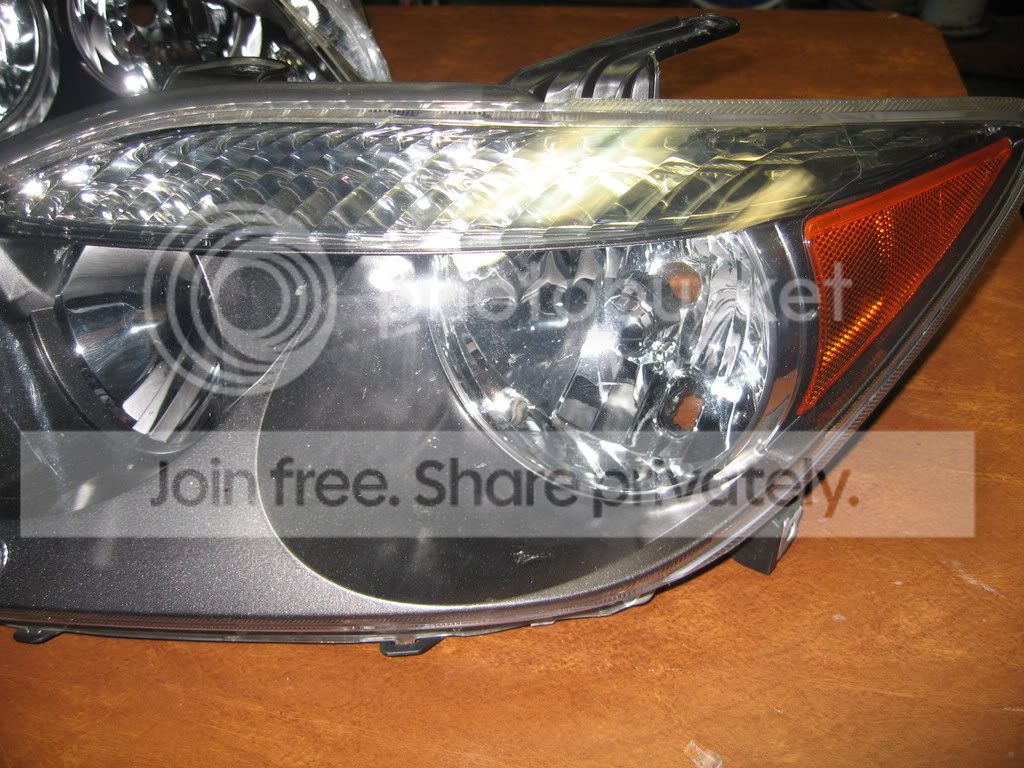

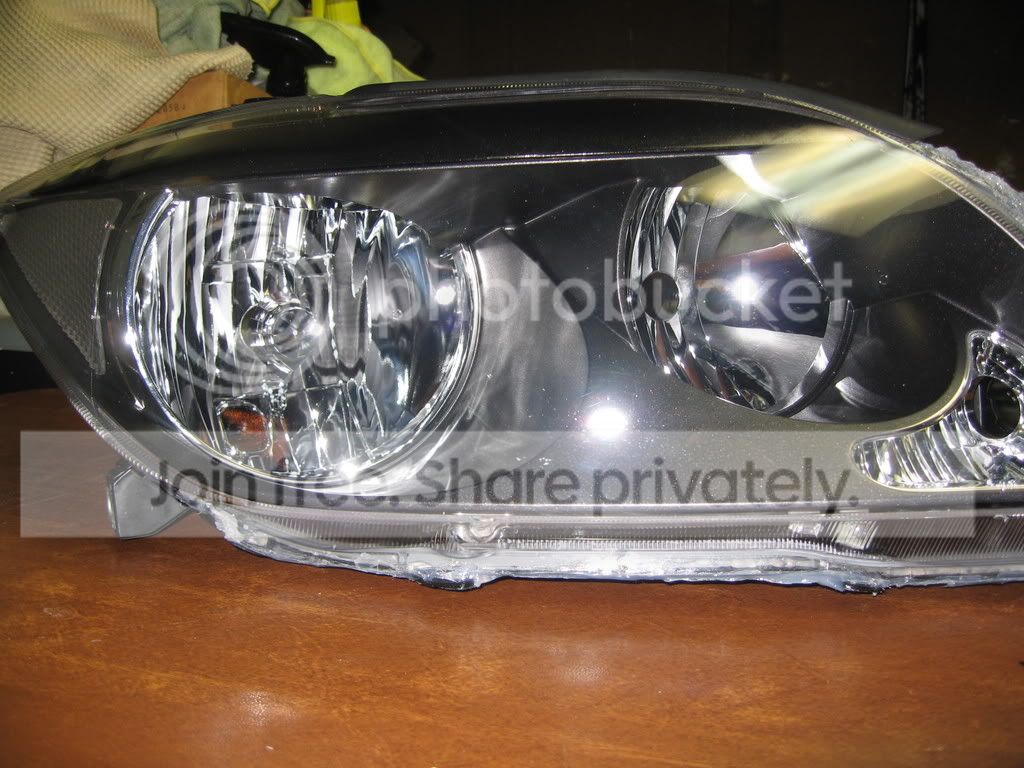

So I finally got some pictures of what the clear corners look like. I started a new project and would like some input. The clear corners are made of industrial seeling light covers and they are put on by little eye glass screws. I drilled into the corners and the light fixture and tightened them on with the screws so I wouldnt have to look at any silicone or super glue. Its very easy to do and looks way clean. Also painted the upper eye to match the car BSP

Nice mod man, good idea with the lighting screen. I think it looks real good.

eyeglass screws......... god............. why didn't i think of that?!
Old Apr 25, 2007 | 05:59 AM
Viace's Avatar
Posts: 929
Hahaha I know I sat there for the longest time thinking of how I can do it and have it look clean without all the glue gunk, it was risky but came out perfect.

so u used the lamp covers from commerical buildings...

dang what size drill bit did u use? looks nice and clean

the drill bit was small as heck im not sure what size, and the plastic for the corners is just the covers for the light in like schools and home depot, pics will hopefully be up tomorrow of them on the car, I have to do the other light
