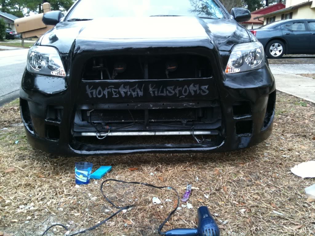

better view from far away after i got to my moms so it stayed on on the highway luckly
[IMG]http://sphotos.ak.fbcdn.net/hphotos-ak-snc4/hs293.snc4/40991_10150235395815475_810450474_14436870_5183177_n.jpg[/IMG]
painted and some body fill
no body fill just painted in the rain with spray cans
that once area getting smoothso i made a paper model of my bumper to design the wind spliter cause i suck at drawing
cut the whole bottom lip of then made a new one out of foam really quick only 3/4 inch now instead of 3 inches to make room for the spliter.
fiberglassed and on the car.
