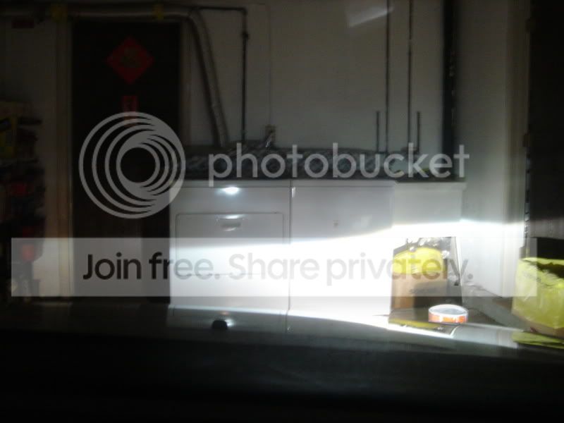

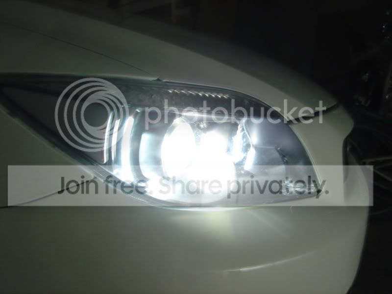

I just finished putting one of my retrofitted headlight back in...
Here it is... E46 projectors w/ custom shroud...

not bad roger, what did u use for the shrouds?
Old Dec 25, 2006 | 10:39 PM
ricexizxgood's Avatar
Posts: 1,834
From: San Francisco, CA
I just used one of those pipes for plumbing.
I might redo this retro fit soon because the projector is a litttle too far out. It was pretty hard fitting the E46 projector in cause the back was kinda big.

Damn that's a clean cutoff.

why not use the e46 shrouds?

I used E46 projectors for retrofit before, and one mistake I made was not covering up the projectors. Looks like you made the same mistake. That's with your low beams is emitting lights everywhere, which may causes glare. If you have a chance, cover it up with something

Have you seen the e46 projector yet? there are large open spaces between the lense and the bowl. That's why his/her low beam lights scatter everywhere instead of centralizing within the lense.

I know what you mean. I might redo this w/ TSX projectors later on.
I couldn't make the E46 projector sit far back enough to fit the shroud there.

The problem with these E46 projectors is that the distance between the lip of the bowl and the lense is much longer than the distance from the bulb holder to the lip of the bowl. So, it is understandable on how you can't fit the BMW bezels.
