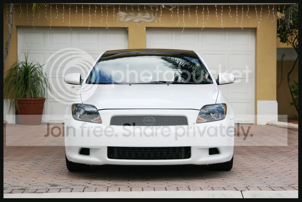

So I've had this lower grill sitting in the bedroom for what seems like 3 or 4 months. I finally got off my butt today and decided to attempt this mod.
At first things went slowly because I wanted to figure out if I wanted to retain the chrome piece or not. I finally decided on keeping it, and had to figure out where to cut. The whole project took about 4 hours and cost me $5.xx for Loctite Gel Epoxy.. besides cost of the grill.
Here are some pics:
BEFORE
AFTER
Closeup...
Overall I've very happy with it. We'll see how long the epoxy lasts..

I didn't follow any DIY, but if you mean if I have one, sorry I didn't document it. Here's what I did though..
Took the grill apart.
Cut the mesh part of the stock grill out - leaving only the outside.
Placed stock grill insert over bottom grill and marked the cut points on the lower grill
Cut the lower grill, using the bottom of the lower grill as the bottom of the new upper grill.
If I would have done it again, I would've measured to get the exact height I need.. as of right now the top doesn't really touch the edge.
Once the grill is cut to size, I used epoxy to hold the new grill insert to the rest of the grill.

No sanding of the epoxy was necessary since I didn't overdo it.
I didn't paint the grill either.. it looked fine stock.
This is just something temporary - I may get VRDs in the future.. not sure though.
