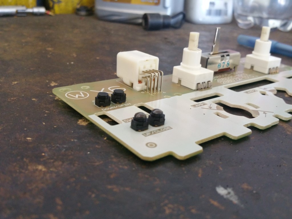

Fixed the prevalent stubborn sunroof switch issue. When attempted to close, it would take a lot of pressure or many tries to get it to move, due to not enough contact between the moving outer part and the inner little black buttons
Put a small dab of JB Weld on top of each button that closes the sunroof, for better contact. It now works flawlessly

is there a thread on how to remove the panel?

Its all easy to do. Whole assembly just snaps into the roof, and can be pulled down by prying with a little screwdriver. Then the circuit part gets separated from the outer part with a small phillips screwdriver

The part listed below appears to be the same switch as what's on the PCB. I plan to order some soon and solder them in to replace the old ones. I'll be getting 4 to replace both of the switches for open and both of them for close. I had previously added a few layers of tape to the plastic that pushes the buttons down to make it push them harder, but after a while it stopped working reliably. After I opened it up again, I found that both of the switches for close have to be pushed very hard before they make contact now. And when they do make contact, they have a higher resistance than the switches to open the sunroof do. So I think they are actually worn out. Anyway, the parts below seem to be an exact match from my measurements. I'll report back when I test it out.
Digikey part # P15958SCT-ND
Manufacturer part # EVQ-PV205K
