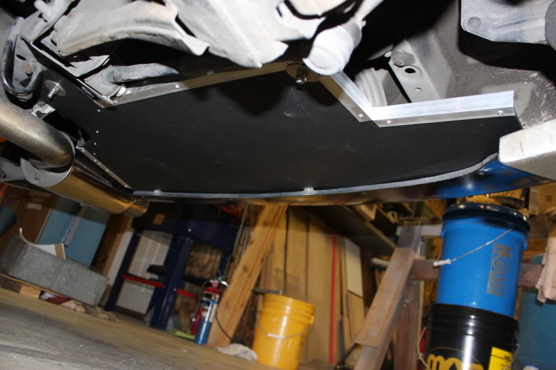

def going to attempt one of these this summer.
BTW Kanchi what are you using on the edges of the abs to give it some rigidity?

^Aluminum angle iron

ah, i see lol i had a brain fart and thought those were the pieces you mounted to the car to mount the splitter too.

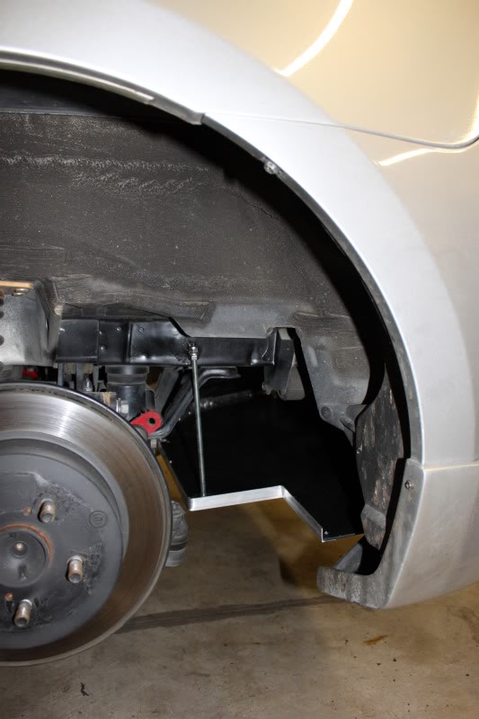

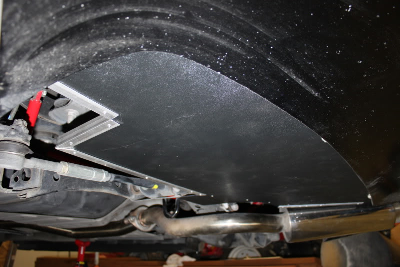

Nope I use stainless eye loops threaded into the subframe then use a length of "all thread" to go from the panel to the eyelet in the corners, then bolt it in the center to the subframe.

Also I finally found the cable to my camera and have pics of how I mount some of the supports for the panel, hope this helps:
5a kit:

Hope this helps

Looks professionaly done!
