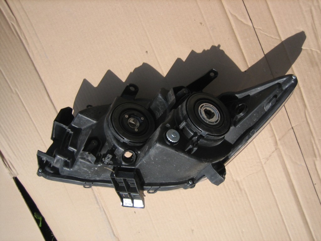

I have 2008 projector lights on my car and they're facing the ground. I want to know if it is that one bolt to adjust them? or how would I be able to do this?

its kind of hard to explain, you need to look for a picture, but theres a place on the headlights where you put a phillips screwdriver in and turn clockwise to aim the headlights up and counter clockwise to aim the headlights down.

Is it that one bolt that is silver right there? the only screws are on the high beam.

Yes that bolt. And its not a phillips screw driver. I think its a size 8 socket or a size 6

^ actually you use phillips tip when the head light is installed to adjust it.

All I use is a 8 or 6 size socket and a rachet. Where would u use the phillips tip for adjusting?

yeah i use a rachet also with a short handle bc its kinda tight in that area
The spikes where the hex head is. Its spiked up so the phillips tip could grab it. Try it.

yea i used to use a socket before, but realized that there was a much easier/faster way. if you look down at that area where that round, silver thing is there will be a piece that looks like this \__/ put your phillips screwdriver in there and turn. that will actually turn the round silver thing. I believe all cars are like this.

Thats interesting. I gotta try that. So phillips and not a flathead?

correct, use a phillips.

also want to mention that when you go to adjust them, it's best to park the car on a level surface and having the headlights pointed directly at a perpendicular vertical object such as a wall or garage door for example. That way it's easier to get both headlights adjusted to be the same height.
