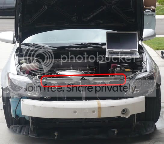

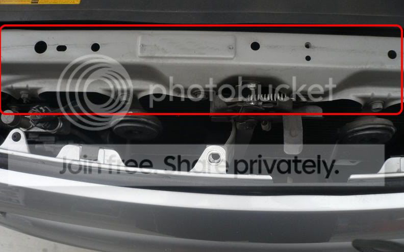

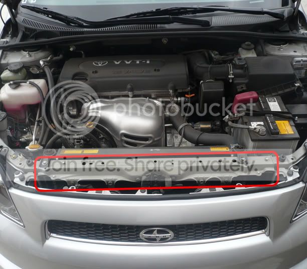

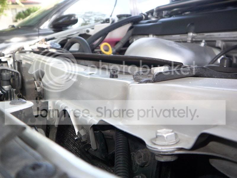

I need the part number of this beam in the engine bay where the horns, radiator, and hood latch are connected. Or does anybody know what it's called?
Do you know where can I get this beam aside from the dealership?
And does anybody know of a DIY on how to replace it?
I stole the images from xIxAMxHOLLYWOODx. Thanks btw!

Radiator support?

Upper Tie Bar.
http://www.trademotion.com/partlocat...=2&catalogid=2

I took a close look earlier and saw 5 bolts. Two on each sides and one near the hood latch at the center like a vertical steel blade. I'm still not sure though...

I just looked at mine...looks like you take a bunch of bolts off, a few nuts, take off the hood latch thingy from the bar since the latch is attached to the vertical support bar. Doesn't appear to be any welding, cutting at all...just bolts and nuts to me.

Yeah, looks like it's easy to replace. I just need to make sure that the radiator won't fall off when I remove it.

Hmmm that may be an issue...just use something to support it on either side...like wood planks or boxes. I doubt it would fall but you never know. Atleast you know its fixable

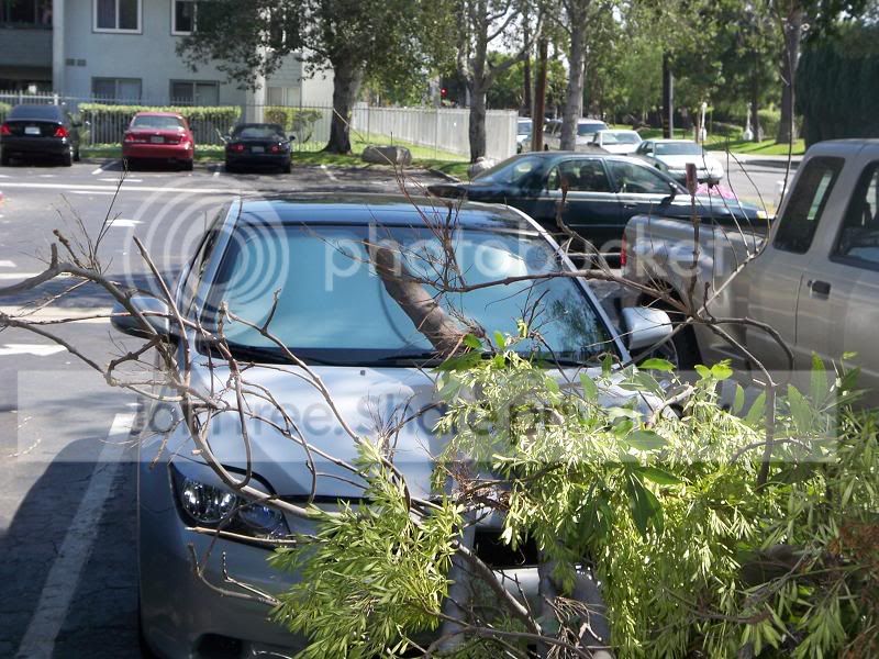

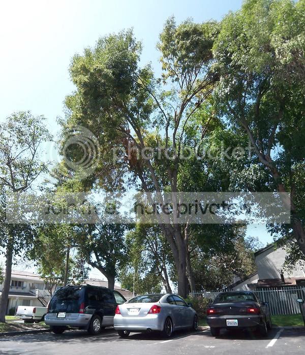

Thanks! Just to visualize what happened:

OH!, now that's just a sh!tty deal man, I was thinking you hit a tree Oh and a safer idea when to take the bracket off is to just have someone else there to hold the radiator up just incase it moves. I think there are A/C lines around there too so you don't want to mess them up from the radiator moving.

ouchie. maybe hit up a pick and pull and get lucky
