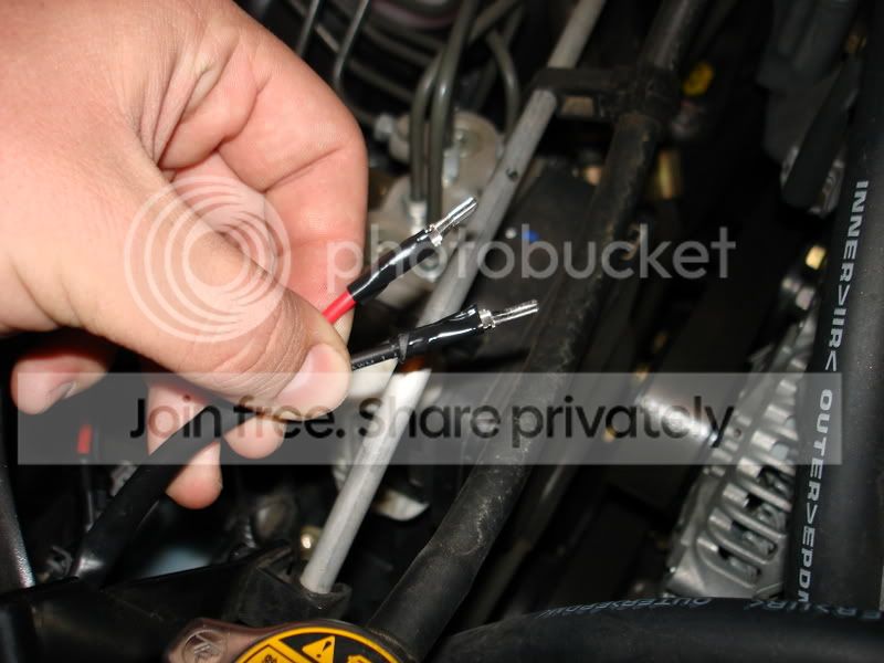

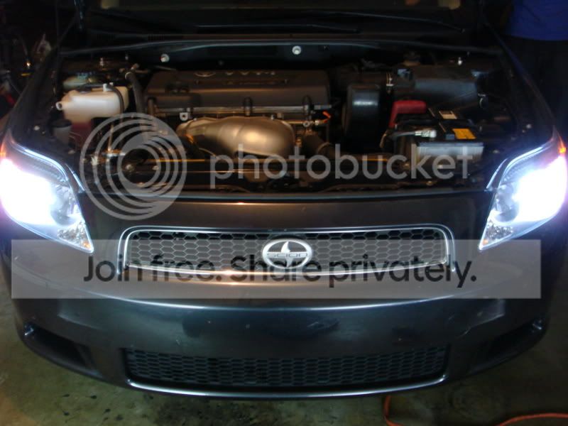

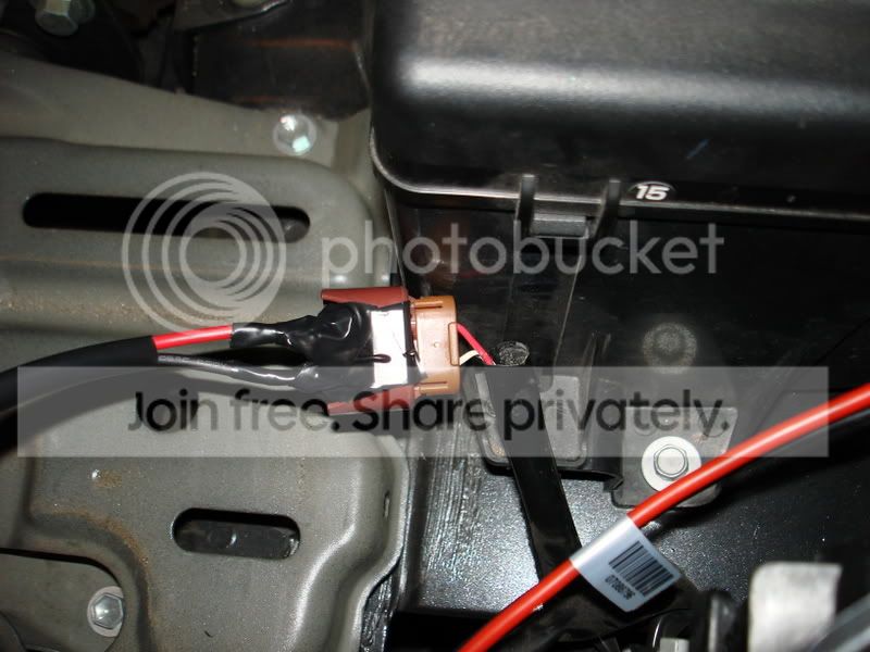

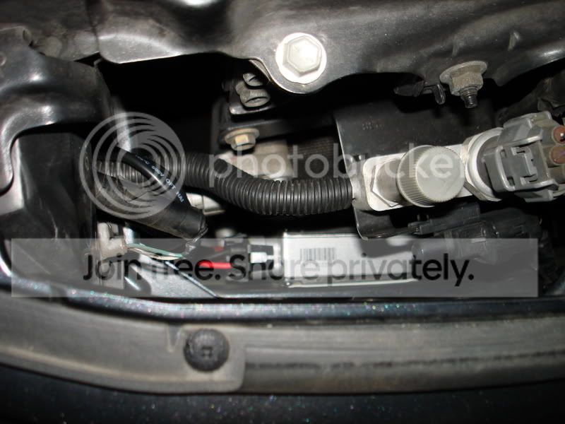

I just installed a 6000k HID kit. Install went pretty smooth and I'm real happy with the result. Here's a few pics.
Before:
My friend David workin some magic with the electrical tape:

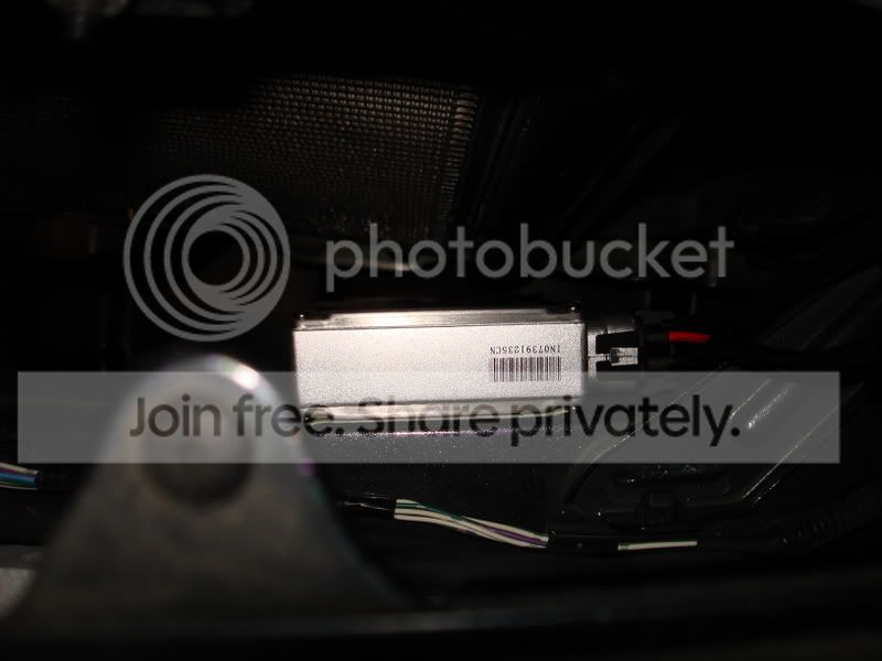

Ballast Placement:

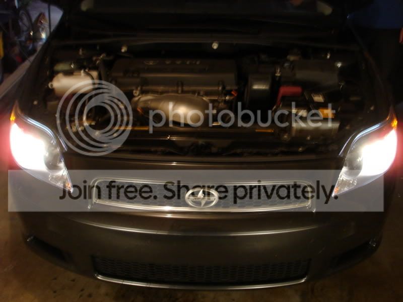

End Result:

is it me, or is that a bad spot to put them in?
Old Oct 27, 2007 | 05:31 PM
davedavetC's Avatar
Posts: 20,410
yea its a bad spot, and wtf kinda kit did you buy? there isnt a 9006 adapter to plug it in? that doesnt look safe at all. a little water and poof there goes your HIDs and your drivin blind.
Old Oct 27, 2007 | 06:04 PM
ScionSean's Avatar
Posts: 104
Another friend of mine gave the kit to me, and it didn't come with a connector to the stock harness, but he told me it was normal that they don't. I thought it was weird that it didn't. Is there one I can buy separately? Or is there a way to take it off of the old bulbs? Also, why is the ballast placement bad? Where's a better location? Thanks

just buy a real kit???
that really isnt safe....
Old Oct 27, 2007 | 06:48 PM
Yanki01's Avatar
Posts: 8,776
From: Corpus Christi, TX
water prone area.

Cut-off is scary.

those are ghost spots that halogens make.
With HID's, they're more pronounced and it becomes a problem as they're the main glare issue.
That is caused by the way light is emitted, hitting the bottom reflector and it will shoot upwards above the cutoff.

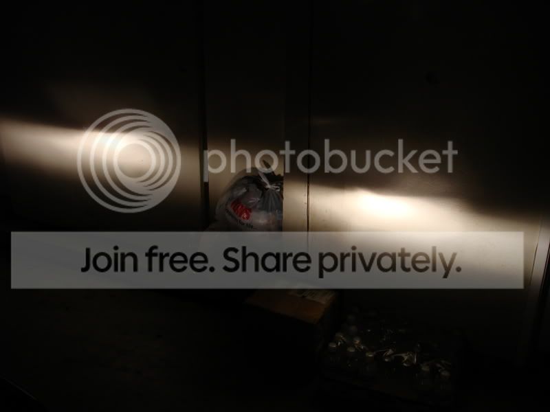

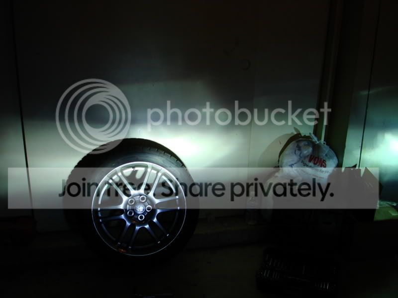

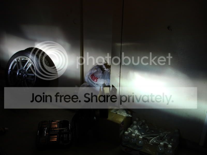

Here are a few shots of mine.
Old Oct 27, 2007 | 10:07 PM
striker_1818's Avatar
Posts: 291
From: Jamaica, NY
^ there's one bad hotspot. Try lowering the driver's side down because that should be enough to even ____ truck drivers off. Also, im sure you and I know the settings of the camera are misleading and also the ghost spots are more pronounced.
I would have used some rebased D2R bulbs instead of D2S if i were you.

Well I got the kit for free so I'm not complaining about the connectors lol. I'm just going to use some insulated electrical male/female connectors and some heat wrap just to make sure everything's good. Where's a better spot to mount the ballasts? It would seem that everywhere in the engine compartment would be prone to mositure.

The glare isn't that bad.
Had my homie follow close behind me in my ride...
Looks way worse in that pic than in person.
Old Oct 27, 2007 | 11:19 PM
Yanki01's Avatar
Posts: 8,776
looks worse in person than in that pic. Seen it first hand.
