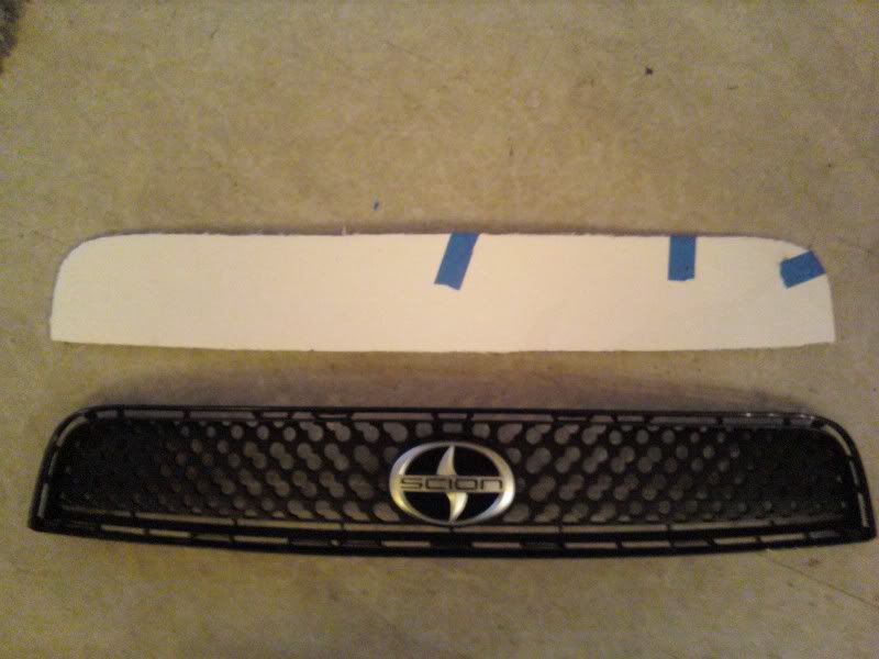

i removed the grille from the bumper. just open the hood, you'll see like 8 clips or something holding it together. thats pretty easy, u'll figure it out.
then, when i had the grille out, i traced a cardboard piece around it to make the shape of the grille. like so....
then, i cut a piece of the metal lath thing about an inch and a half larger than the cardboard that i cut all around.
