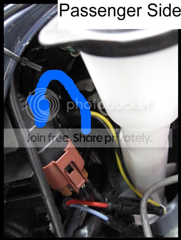

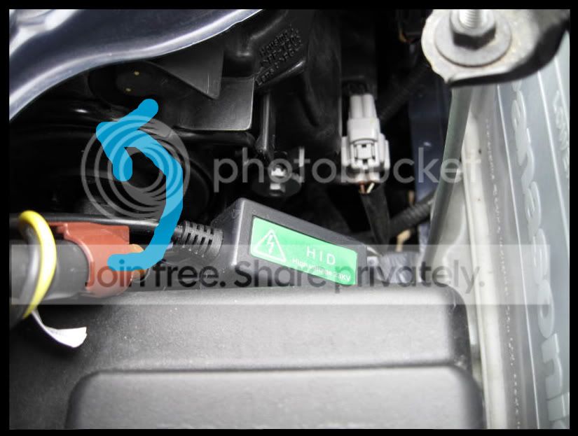

Ok I was bored here you go, the picture of where it is located and how to turn it to get it out. You turn it like annontated (Counter Clock Wise when viewed from the back looking forward) and 1/16 of a turn and pull it straight back
