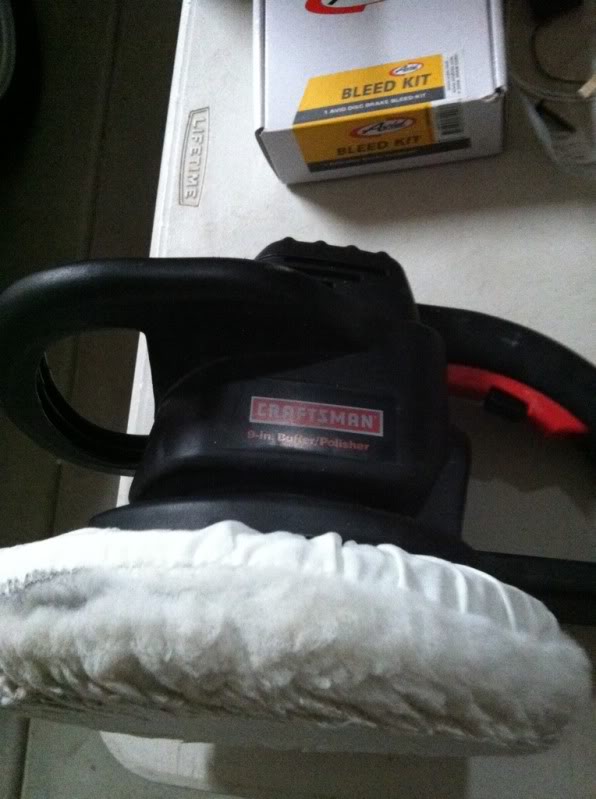

2) a buffer, now there are different types, there is one that spins just in one direction, one that spins the pad, and then the pad also rotates around in its own way. (smoother surface, gets a lot of scratches)

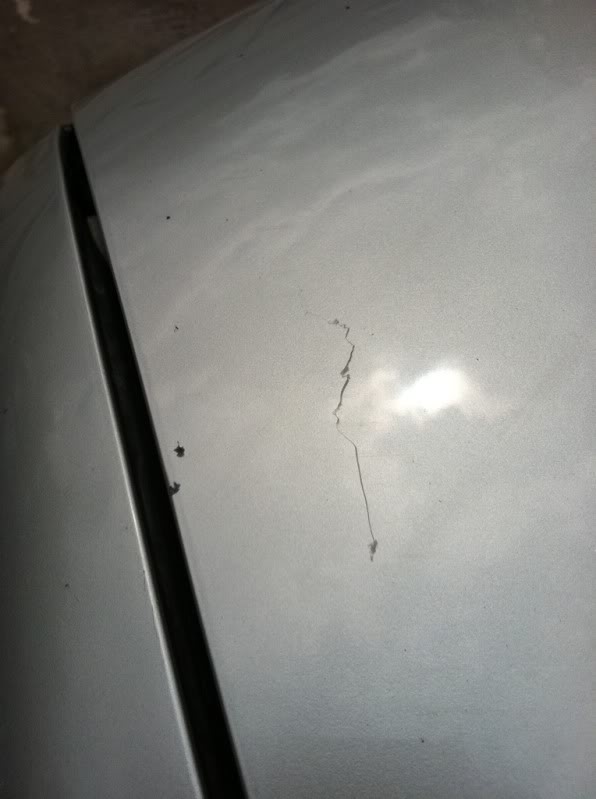

to determine what you will need, is run your fingernail gently from left to right, or up or down, over the scratch, if you can kinda feel it, its not so deep, the more you can feel it the deeper it is.
here is a before picture of what you can tell is a pretty deep scratch, all i used is a buffer and some wax.
BEFORE
AFTER
you can see the big ugly scratch wasnt through the paint, but it was through the clear. buffers basically can heat the paint, and fill in holes and scratches. as you can tell those 2 little chips.
i even took my badges off, and as you can see the paint has faded, you can kinda see the TOYOTA.
with some color sanding and a buff it came right out.
AFTER

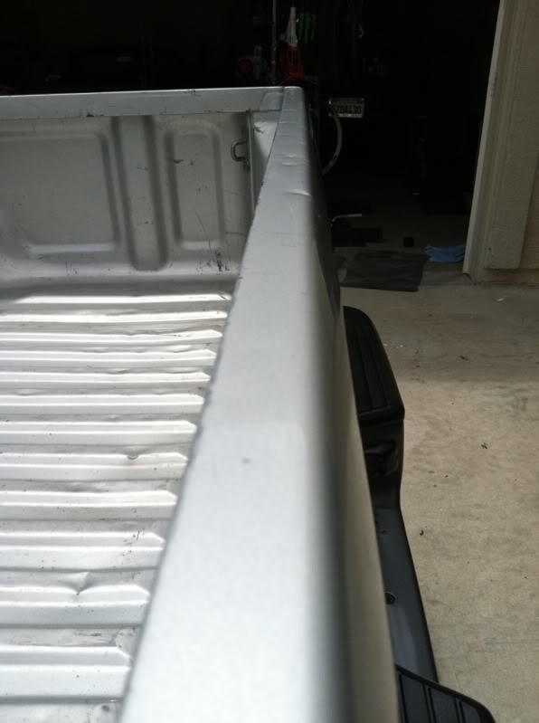

here is the top of my tailgate, BEFORE
AFTER

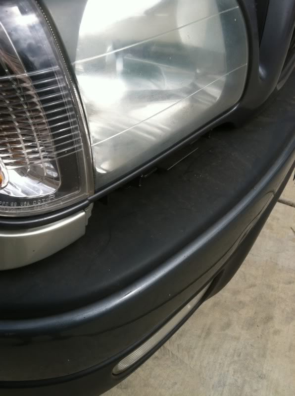

you can even clay, buff, and color sand your headlights, i do it all the time.
forget buying a headlight restore kit, just use these items! even the wax!
BEFORE
AFTER its not a significant difference cause my headlights were pretty clean as they were.
AFTER
BEFORE

it all depends what you want, i moved onto a buffer that i can control the RPM's.
settings 1-6 being slowest 6 being fastest
