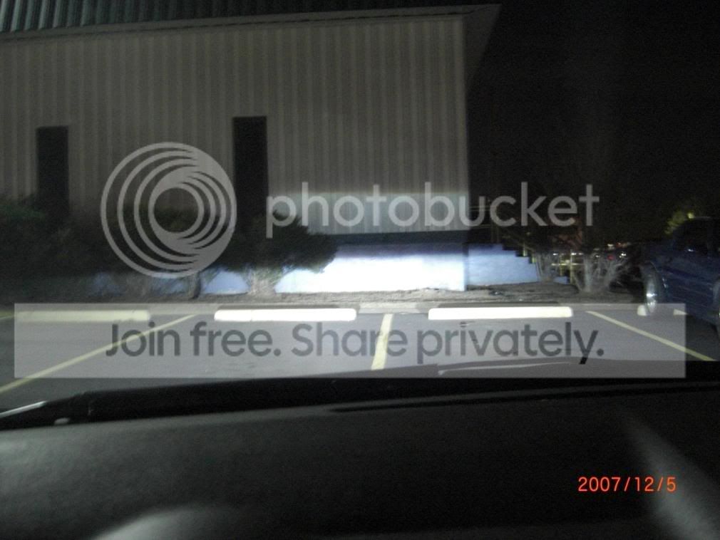

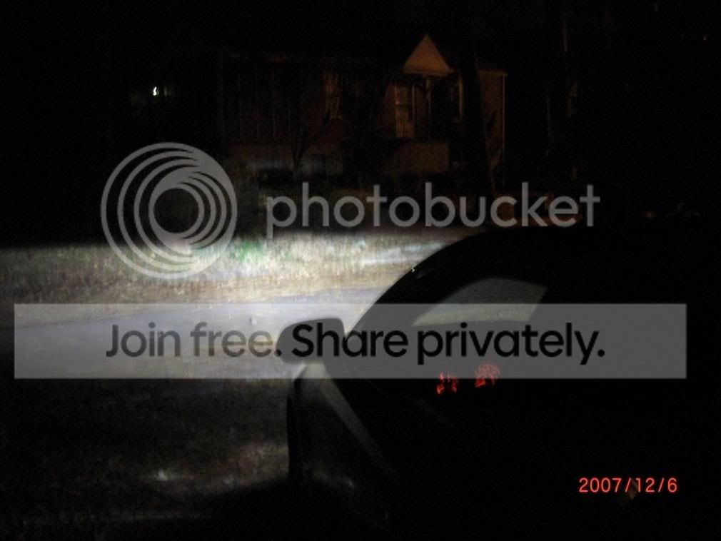

well...I purchased a non-branded kit which was very well made and came with a decent color instruction manual. Had fuses built into the wires...which is for people who don't wanna use a relay harness and It's safe for both ways. Also the ballasts were very slim and made it easier to mount them. Paid $105.98 shipped. Heard good things about slim ballasts. I don't have comparison pics because I was anxious to install the kit but you've seen pics before. These shots are during the day and I will have some night/evening pics up before I head into work. Onto the pics:

actually alot better then i expected. when i had the xentec kit on the street that one light lit up both sides of the road and the oem bulb you couldn't tell if its on or off. its alot further too lol...ill post up some night pics in a few hours when it gets dark.

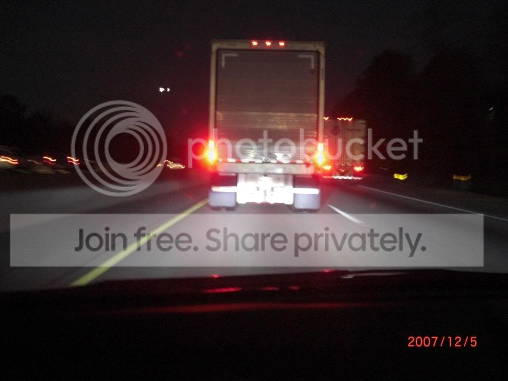

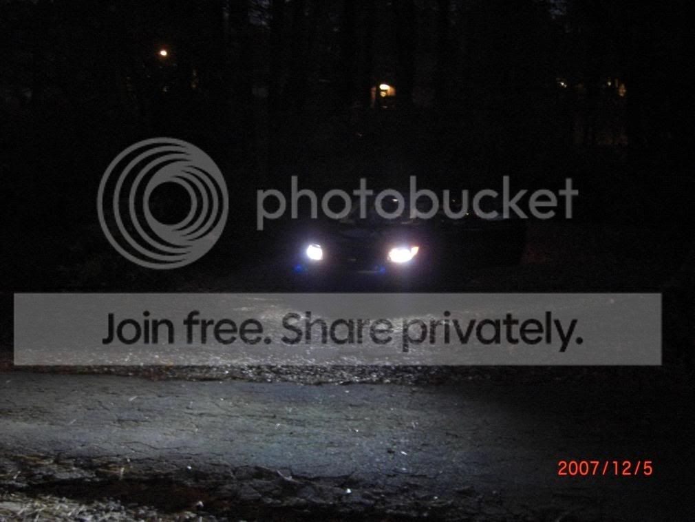

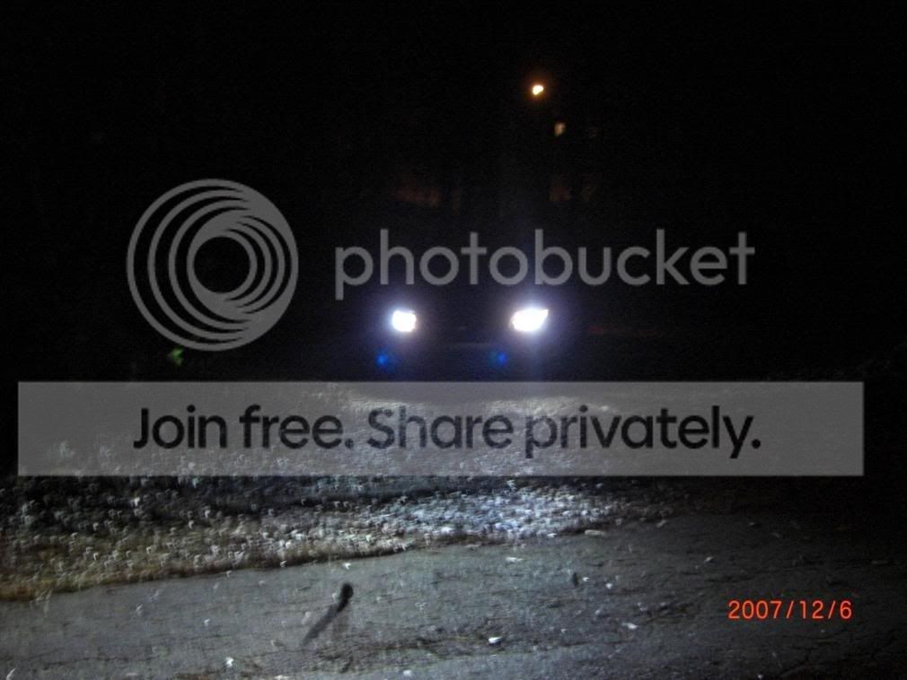

Here you are...sorry for the blurry pics. I took them quick because its in the low 20s here in atlanta

one thing i really love about the hids is that i can see what exit im coming up on the expressway from a good distance back and signs on the side of the road just glow

overall is better than 04-07 headlights any day. i would comment on your 6k bulbs in your kit but I found that aftermarket 6k bulb lumen output tolerances varies vs oem.
small tip for halogen projector hid users:
the top pic where you're shooting at the building shows that you need to either raise or lower the flap inside the projector. dont not make it completly flat just bend until the halo disappears .
the little halo light above the main cutoff shows that your not maximizing your hid distribution which cause a small but slight glare to other drivers.
Looks good, I know what you mean on the signs, Late at night I flashed my dual HID on all four beams on one of them signs and it lit up so bright that is nearly blinded me.
