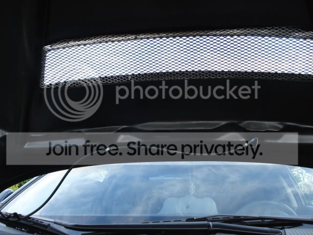

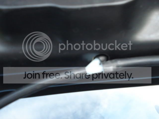

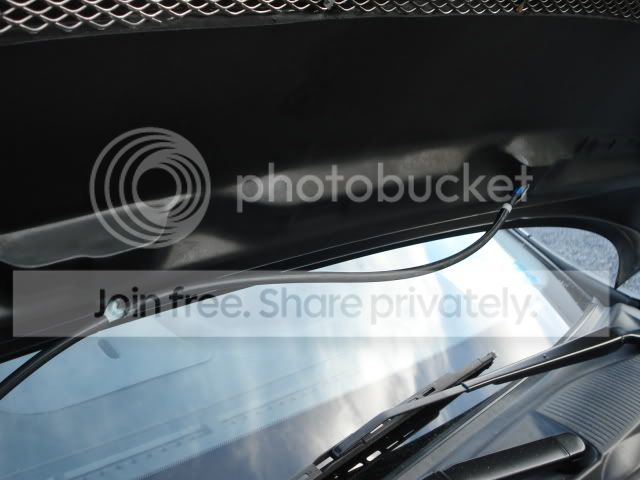

I just got off my lazy a$$ .....I hope these help. They're just hangin now cause i hadn't had time to mess with them or put the cloth back....it came with wholes for the nozzles....
Old May 22, 2009 | 11:27 PM
jamie1tc's Avatar
Posts: 226
From: Hampton Bays, New York
I did make one whole bigger trying to get the pinched line out cause i tried to run the lines inside..... no go on that
