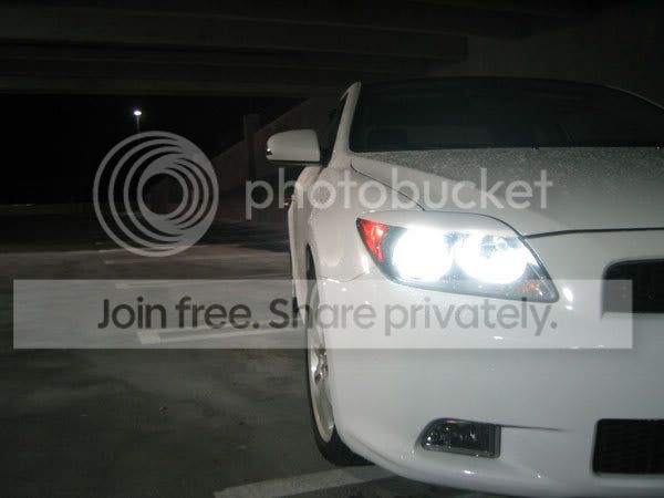

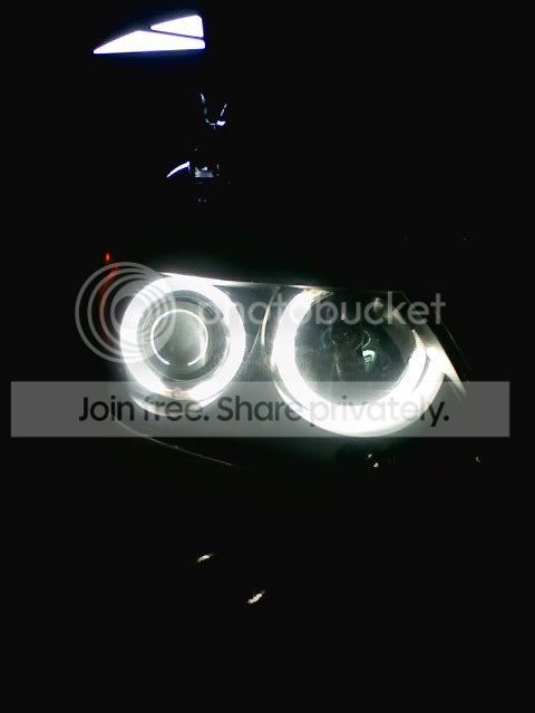

So we all know how dakine left for the Marines. Well he was the one that got me these headlights. So I guess Paul and 05_trd_tc (didnt want to say your real name) got together to mod the cutoff shield on these anzos.
I order an HID kit from cliff a few days ago and it came it yesterday. Install it this morning after class...and voila. 6000k yummy
THESE ARE THE HALOS
HIDs on

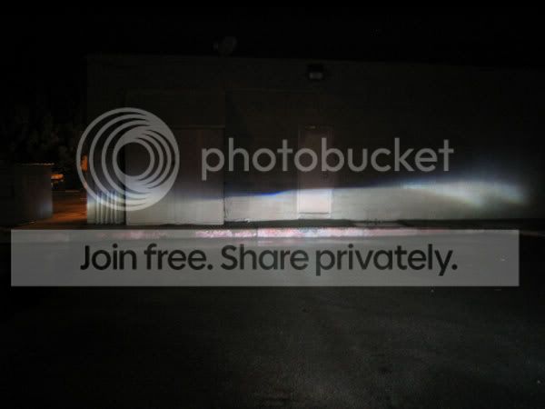

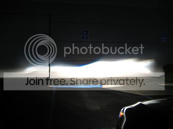

Wall shot (30ft.)

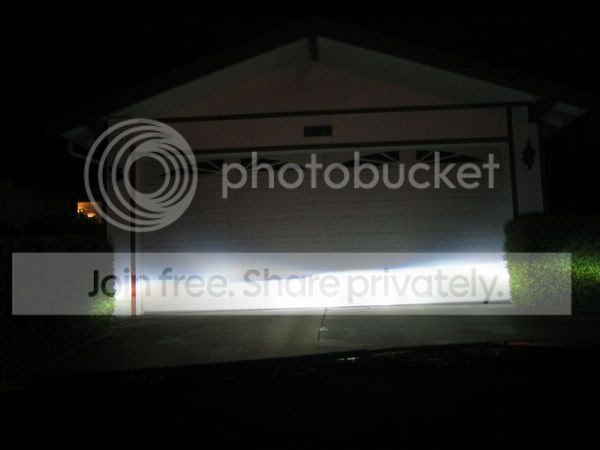

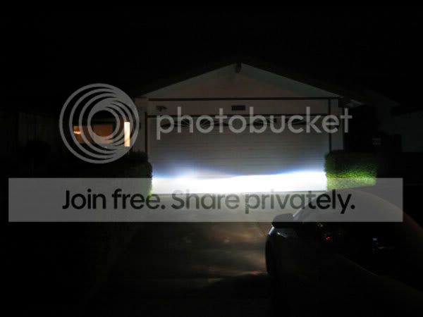

Garage shot

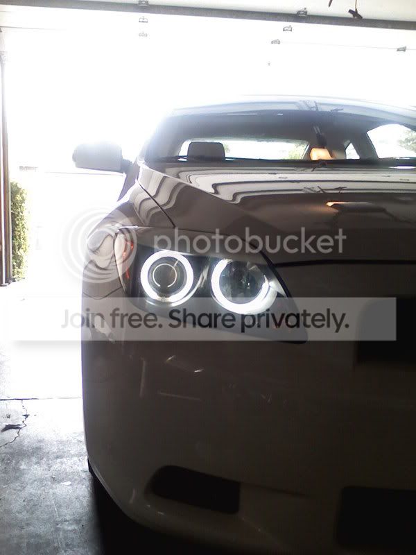

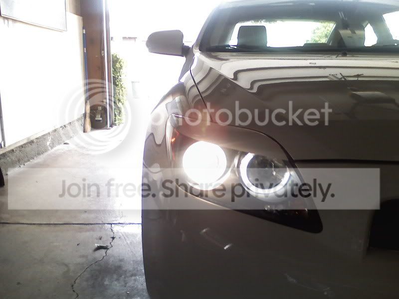

My tC for safe measure

I know these are not HID projector quality. Im planning to retro so e46 projectors into them over summer.
The foreground lights up pretty well on the roads. I havent tried to put the HID bulbs in the other way to see how it lights up the road yet...ill do it tomorrow.
The beam pattern isnt as wide as it the OEM reflectors used to be. Pretty disappointing.

Do you guys think the flare on the left side of the beam is going to blind people?
COMMENTS PLEASE! GOOD AND BAD ONES

I think HIDs in stock ANZOs are HORRIBLE. Atleast with my modded cutoff...it doesnt blind people

that isnt tooo bad imo (the cut off)..
haha GREAT MALL PARKING STRUCTURE!! lol

That looks a lot better than HIDs in an unmodded Anzo headlight.

that cutoff wouldnt be as bad if it didnt have the light flaring above the defined cut off.

To mod the cutoff, you have to bake it open and alter the cutoff shield. What paul and 05_trd_tc did was screw a plate which added to the shape of the cutoff shield making it more sharp and defined.
Chime in for me 05_trd_tc.
However, they did screw up on resealing the passenger side. I had to redo it. ATV sealant ftw and the messiness
