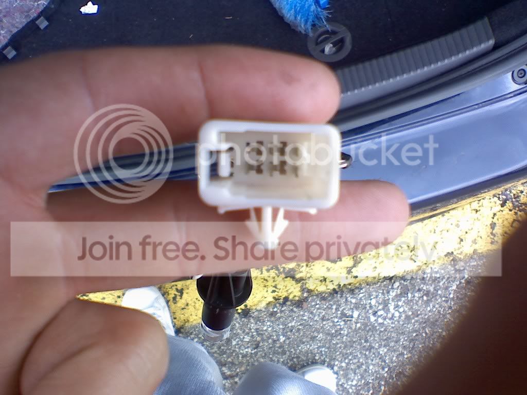

So i am going from stock tails to smoked anzos, and i have no clue on how to hook them up... they dont have the same harness as the old stock lights, i don't know how to put the backup lights in..
Here are some pictures of the connections:
The black ones are from the tailights, the white one is from the car...
Thats the old harness from the old tails

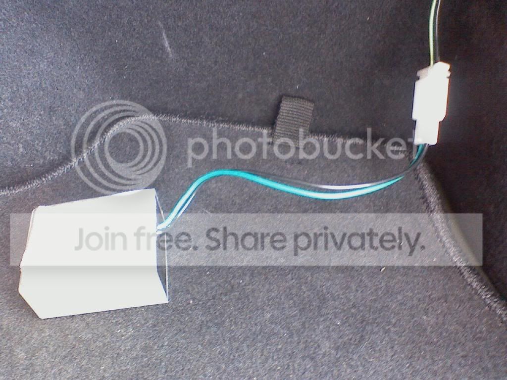

and thats a box that i have no clue what it does. i think its a backup battery? idn...
Anyone have any insight on how to hook them up?

you hook up the black clips to the oem harness, then i think you plug the box in to the car

You're going to re-use all of the wiring from the stock lights. The black plugs on the Anzos plug into the light bulb sockets of the OEM wiring.
I think polarity matters too, so make sure you test every function before you put your car back together.

you have to unplug the stock harness from the stock lights and use the anzo harness . thats how i did mine

but the black plugs just dont go into the harness... where do they plug in... im obviously missing something here... i need a step by step on how to do this lol...

1.Take the wiring completly out from the stock taillights. 2. Pull the bulbs out from the stock wiring harness. Now where you pulled the bulbs from is where you plug the black anzo plugs into. Remember which one is the blinker bulb and which one is the break bulb. The black plug on the anzos that is towards the top is the blinker and the one on the lower part is the break. Make sure you plug everything in the proper way or you may blow fuses.

No cutting at all..........the new harness in the Anzos goes into the old bulb harness......not the connector that goes to the bulbs.....unplug a bulb and you will get it.

haha i just figured it out! im i retard!
