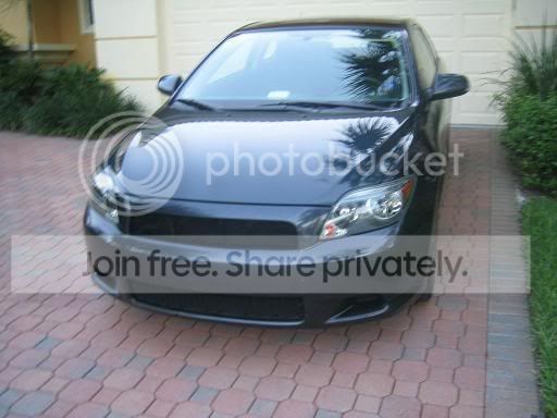

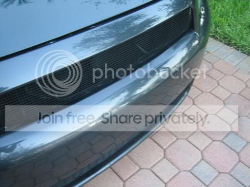

you got ripped off by autozone probably they charged u so much for mesh, lol....anyways......ok heres how i did it, without drilling holes........i kinda played around with cutting small holes into the mesh and making them fit the tabs, just get creative. I've had it holding on to the tabs for a week and every day i take highway to go to school and its held on......its very hard to make mesh look perfect, in fact it probably won't look perfect you might as well save for a real grill if you dont like some imperfections......
im probably going back to stock with mine but heres how it looks:
You can see that it isn't perfect in this picture, you can't tell from more than 2 feet away but im not happy with imperfections so im probably going back to stock until i can buy a premade grill
