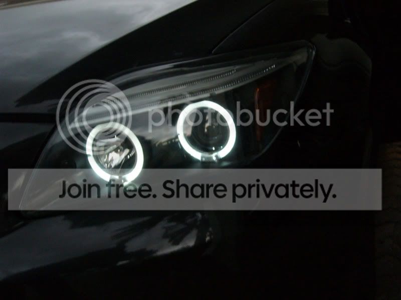

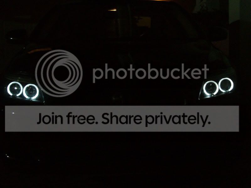

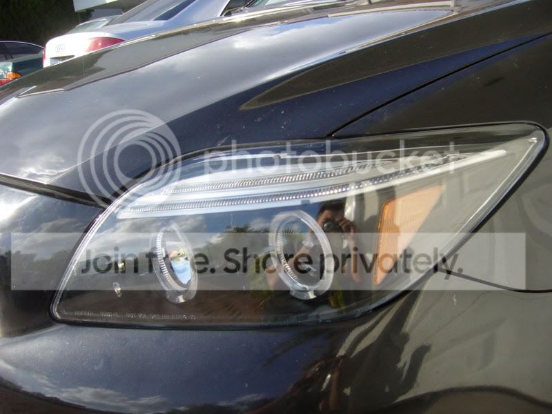

Well after searching i decided to get these lights.
They fit perfectly and the looks are pretty nice.

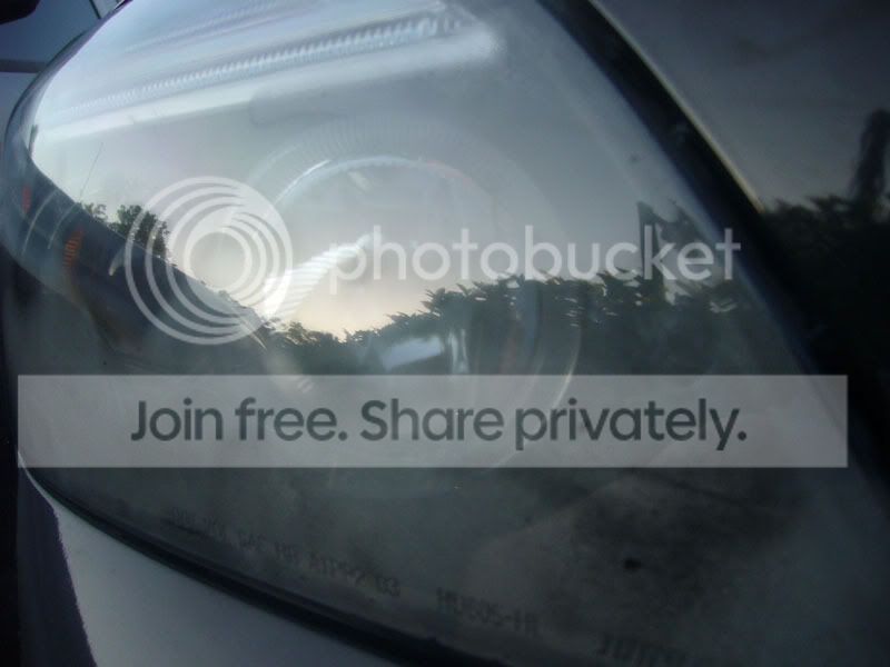

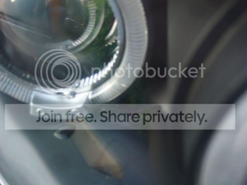

But After i washed my car the next day this happened
There is the Culprit!

ahhh yes condensation..... most aftermarket lights will do that do ya.

ahh yes, same lights. same problem. my passenger side one is doing that. but since it hardly rains here and it goes away within a half hour after i wash it, i don't really care.

ya its my passenger side one too, oh well i took it out and im sealing with with clear silicone that should hopefully solve the issue.

Yeah 98% of aftermarket lights especially halos will do that just seal it again and it will be fine.

make sure it has dried 100% so you dont trap any in there as opposed to keeping it out of the housing.
