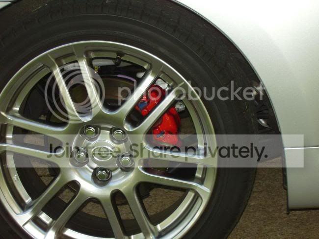

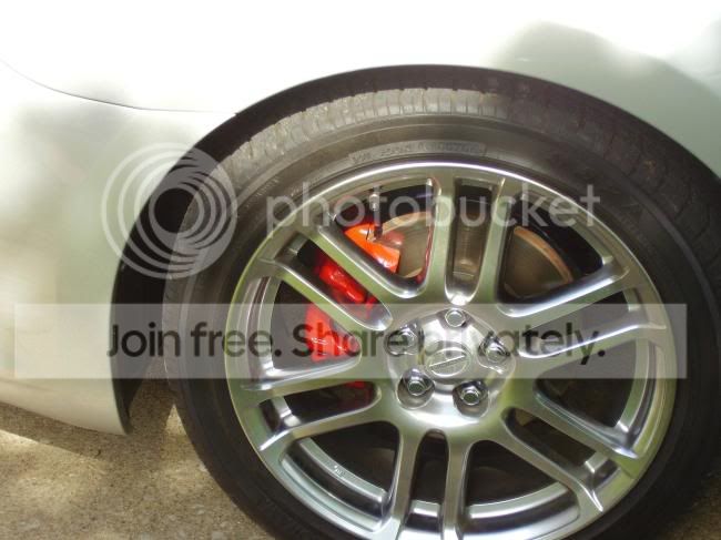

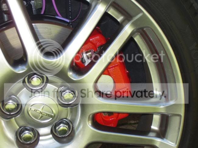

I was bored this morning so I decided to paint my calipers. Took me around 3 hrs to do all 4 calipers. Here are some pics, tell me what yall think

looks good

^^ x2

Looks great

looks very clean, good job
