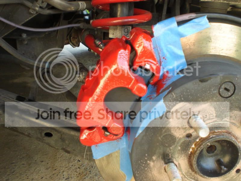

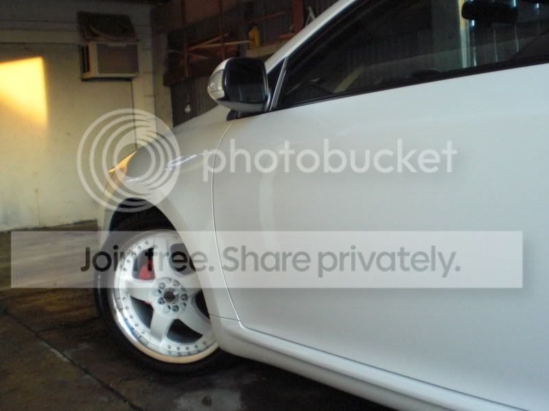

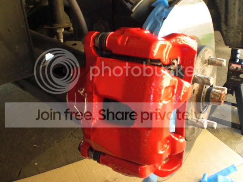

Here are a few pix of mine while i was doing them....
...and waaalaaa!

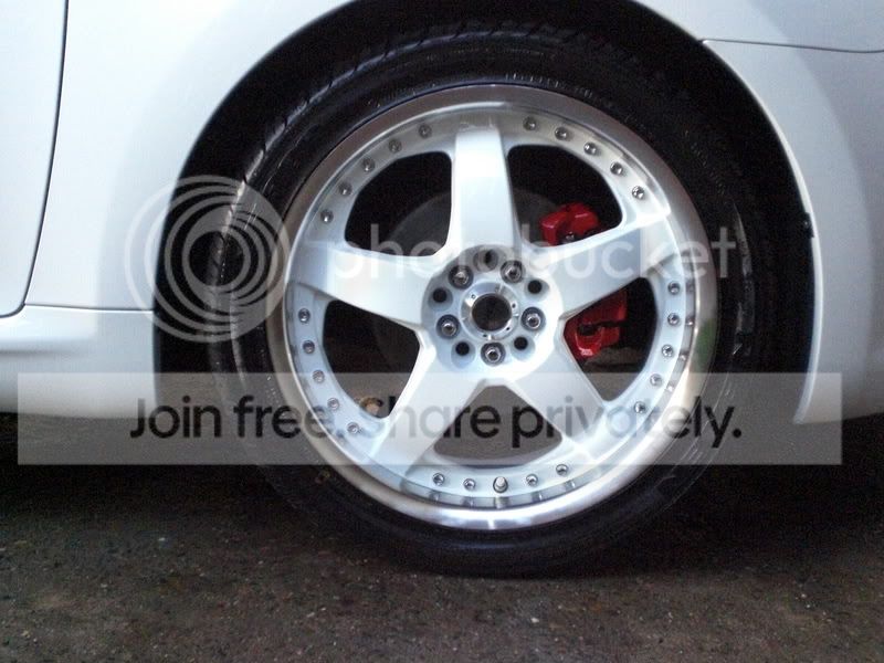

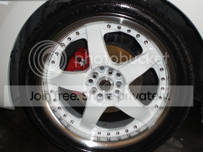

Here they are with the rims and tires put back on.....

^ very nice!

No i did not sand them....did not feel they needed to be, but thats just me. Its pretty basic: Buy the dupli color caliper paint kit @ autozone or kragen it comes with detailed directions and everthing your going to need for the job. Its around $17and it comes in red, blue or black. It just takes a lot of time and lots of coats. Must be patient and that was the hardest part for me.....because if you rush it will not come out beautiful! And you cant drive it for 24hrs.....to let the paint fully cure . And dont forget to use rubber gloves (does not come in the kit). If you have any question holla at cha boi!
By the way if you can jack up the whole car all at once it will be way faster...i did two at a time because my drive way is uneven and was afraid to have the car up in the air .

i'm assuming from the pics that you left the calipers on the car while doing them, that must have been a lot of newspaper cover up and masking tape, lol
looks great though, i will have to try this out soon.
would the engine enamel work as well? i was just at autozone last week and compared the caliper paint and engine enamel (which i already have a few cans of) and they seemed like basically the same stuff.
