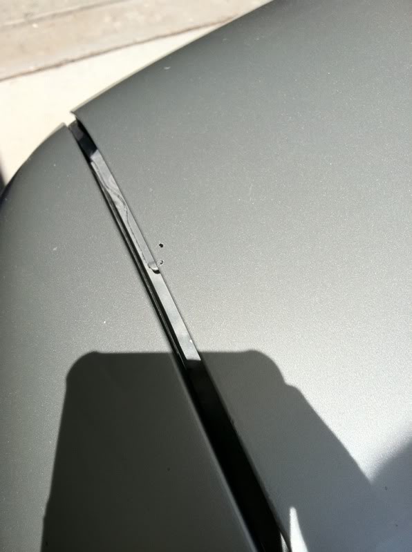

paint pens are harder to use then a buffer. but the finger nail thing is what you need to do to determine how deep it is and what compound to use.
go to sears and get a buffer, and then some wool buffing pads.
if its deep you might have to hit it with a rubbing compound, but all my sorta deep scratches come out with wax.
heres a before
and after, not completely gone. but all i used was a buffer and wax.
goes to show you dont need to get the paint pen, if that doesnt work try different compounds and if that doesnt work then you can color sand.
