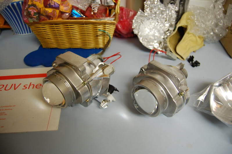

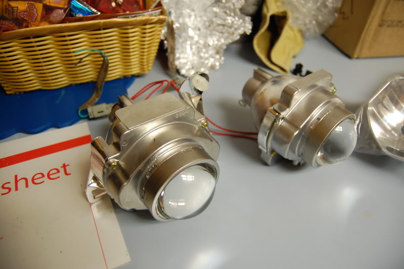

Okay so long story short been working on my quad retrofit for a long time because ive busy with school havent had much time for it.

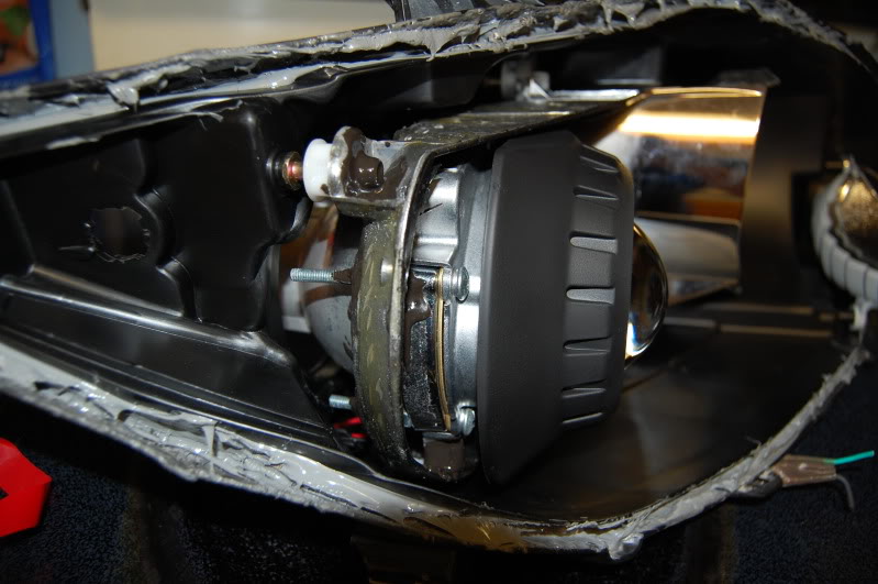

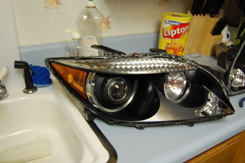

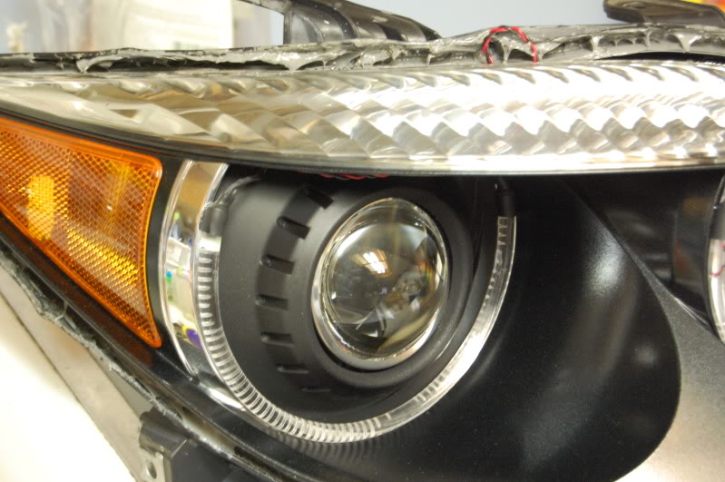

anyways You will hopefully see that the outside lip of the "Gatling Gun" shroud is touching the headlight lens. Ive tried several different ways to get it to not touch. such as trimming some of the shroud so it sits deeper in ...actually trying to move the whole bracket back.(pictured later with the ball joint thing) The fx projector is mounted with screws that are on a bracket on the reflector but i jbwelded the screws so thats out of the question
So my last idea is to change the gatling gun shroud which i have now to the GTI-R shroud at theretrofitsource.com
What do you guys think. i think the gti-r will look good complimenting the other shroud i used for my tsx projectors
Heres pics
i even tried shaving down the little nub behind the ball joint thats part of the housing to move the fx projector back
theres bigger pictures in my flicker if you want to see

whoa, your fx35 projector is sitting WAY tooo forward!
how did you mount them to the reflector bowls? i think you should start there,
heres a pic of how far out they should sit and still have clearance behind the headlights

you can see in the last pic the best of me trying to shave down that stub part..i can shave it down more but onthe opposite ball joint its a different height and that one is flat with the plastic of the housing. couldnt really get a good pic of it. but if i shave them down more ..the outside stub will be probably flat and the inside one will be inset and i wasnt sure if i wanted to do that.
Chico. hope these pics help there maybe a 1/4" out further that yours. Thats a lot sorta in my case since the gatling shrouds stick out flush with the projector lens. where as the GTI-r wouldnt. and i could probably get a pvc fitting or make somethign that would cover that small 1/4" that the GTI-r shroud doenst cover.

yeah bro, your projector needs to sit back just a tad farther back, it would completely fix your problem
with any other shroud (at least ones available at the retrofit source) you would run into another problem, the shroud will hit the top and bottom part of the headlight trim, when i used the e46 replicas on the retro i did, i had to grind down the chrome ring part of the light trim, i was able to do that because the halos hid the grinded part 100%, otherwise i would have had to push the projector back even further, and run in to clearance problems on the driver side rear.
did you trim your fx35's to the max?

this is the problem you will run into with any other shroud, you see how the shroud is off center? its because the oem Trim plastic is pushing the bottom inwards, and that wasnt even fully closed. i remedied this by trimming the chrome ring on the factory plastic.

Ive already had to trim the headlight trim. And the gti-r actually are a smaller diameter. there 107mm and the gatling are 120mm and what ever is not covered ill paint black and ill try and see if i can find some kind of plastic to cover it. This is kinda why i was leaning towards the gti shrouds because you will see the corner of the fx at the bottom that protects the sheild loop part and the sides are not covered by a 1/4" and that you will only see if you look at an angle. But i wasnt sure if the gti shrouds would look good thought.
i have enought clearance in the back of headlight when they are the car to take the bulb out thats kind of what i was going by when i was fitting them. and yes the fx are trimmed to max
Thats the problem im having with having the shroud hit the outside lens is that its pushing the fx projector beam down...
the other option is the not crank down the screws on the headlight bout 1/8" from tight and just fill the crack with some butyl tape which i have anyway to seal the holes in the back of the headlight
