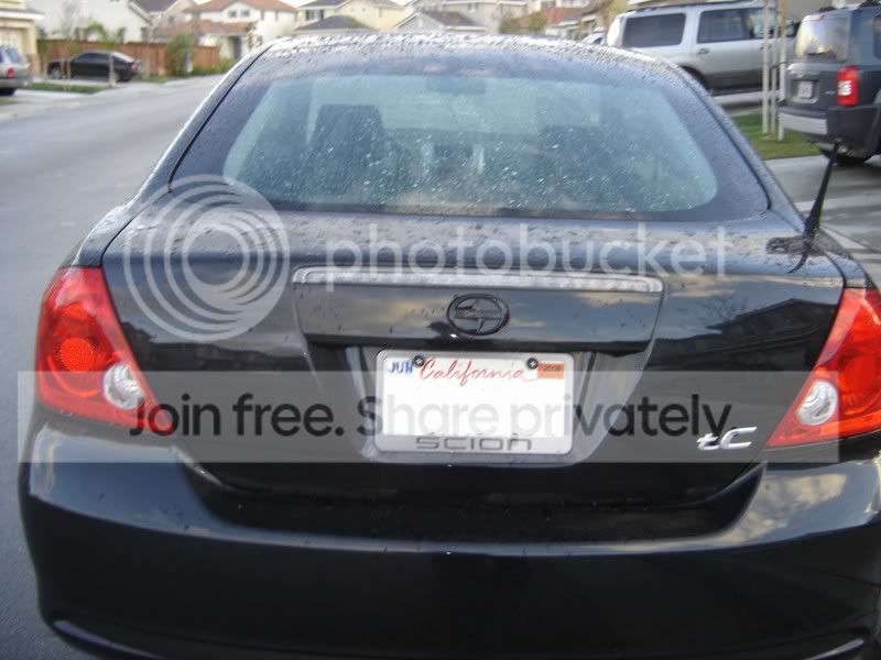

Here's a little write-up I did for my thread...
Originally Posted by Hyghgynx
Biggity-BUUUMMPP!!
So, I got tired of my plain black rear Scion emblem. I was bored on my day off and decided to paint the "SCION" portion silver. For those that are interested in doing this, here's the materials used...
One "Scion" rear emblem...
One can of Dupli-Color Engine Enamel... (Choose a color of your liking.)
One can of Dupli-Color Acrylic Lacquer...
One Metallic Silver Sharpie...
Quick recap of the painting process;
1. Wash emblem in soapy water. Let dry.
2. Use paint and apply 4-5 LIGHT coats. Let dry completely before adding another coat.
3. Use lacquer the same way as the paint. (Refer to step 2.)
4. Color in "SCION" lettering with Sharpie pen. Have some Windex and a micro fiber cloth handy incase you "color outside the lines".
Your finished product should look like this...
That's all there is to having a sweet looking rear Scion/tC emblem!! Good job!! You've earned that beer!!
Same process for the front emblem also.
Of course you could sand and prime the emblem, but so far mine has held up for 2+ years now.
This has to be one of the easiest mods out there.

I bet it would look like this...
(didnt get to paint the "tC" yet, debating it..

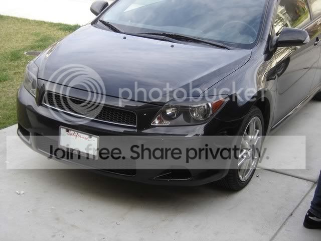

that look good. i have the tc on the from grill so i would leave it i think.

Thanks, I like it. Its only temporary till I install my badgeless grill and find a cf hatch garnish

i love the way it looks with the tc in the front when its badgeless
