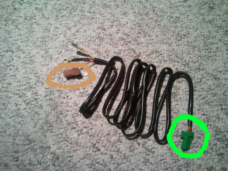

hey guys ive been having trouble trying to install these; im pretty lost. if you could please help :D. walkthrough maybe

hey yea people tend to have probs with this kit,
diy here
plus this vid helped, ignore what the kid is saying tho just take notice where the brown plug is connect to the white plug
and the the green connector is in the switch.
http://www.youtube.com/watch?v=y5U8uMRl-U8
same process
take apart the black rubber thing, yellow goes to the fog, black goes to negative (of course), green goes to the switch, and the red with brown connector goes to the white headlight plug within the dash

i hope that was clear enough for u

it doesnt really help me.
is there a step by step
im still lost with what to do with that brown piece.
