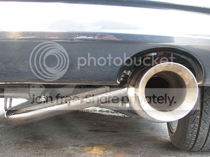

Edit: Heres a pic of my exhaust, its about an inch or an inch and a half from the bumper. Ive felt the bumper above the exhaust after driving and it wasnt hot at all so I wouldnt worry about it. Im lowered on TRD springs also.

Thanx a ton you guys for bringing this to my attention. Saved me from a big big screw up. I went and checked out my bumper and saw that under the cut out for the exhaust the paint was coming off and the rest was wrinkling from the heat. So i used every adjustment and trick i knew of to fix this problem. I dunno where the problem lays. I loosened the bolts holding the axle-back to the midpipe, tugged and pulled on the hangers and used the zip tie trick to buy about an inch of clearance. Here's some pics:
