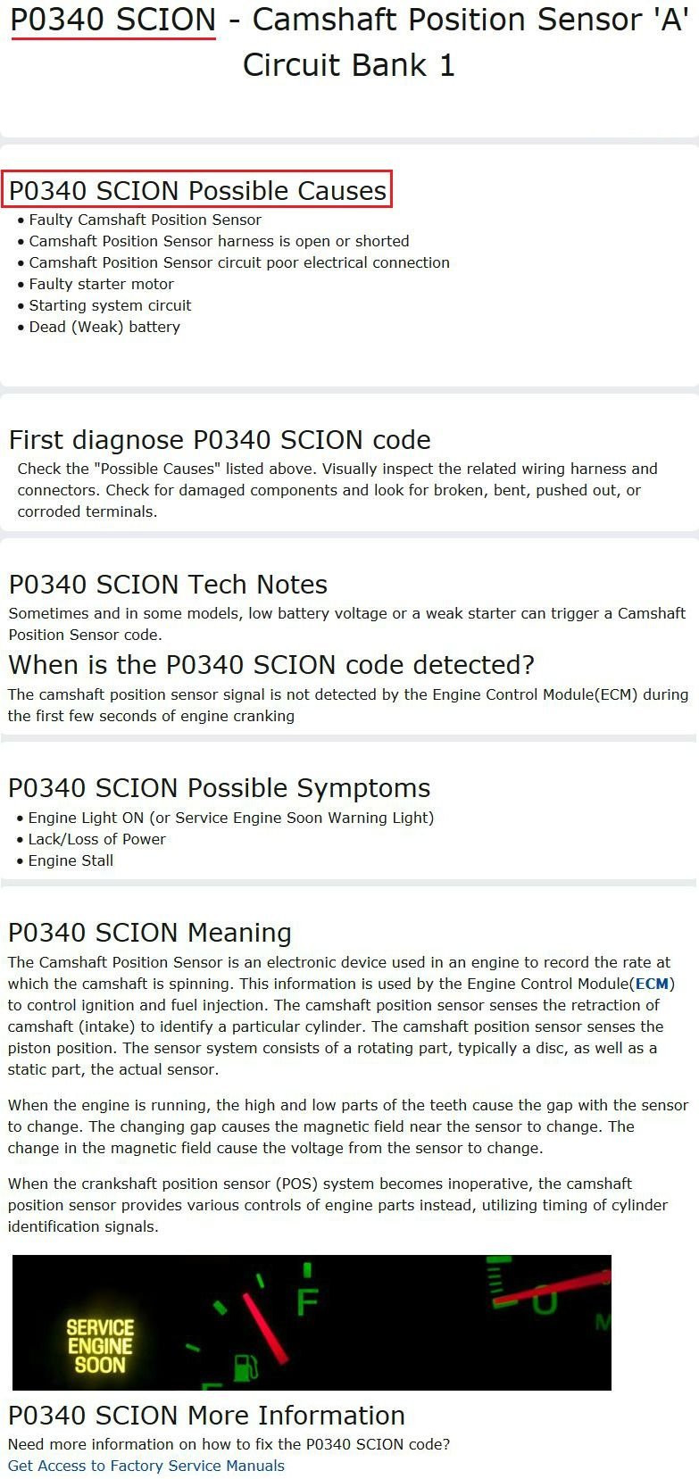

Yes, Code C1241. Also have gotten Code P0340 and C0278. I got a new relay and tried that in different spots but same problems occur.

This is the Most I can Find.
Hope it Helps,
MR LUV

thank you. I have read all this and tried trouble shooting the best I can. But nothing has changed.Only 1 code comes up at a time, and not alway the same 1. Everything I have read says it’s almost never the ECU but that what it feels like to me.
