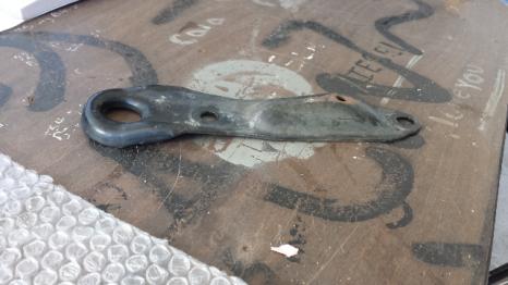

Anyone recall where this piece goes? Looks to be a part of the subframe

Aw man, I'm sorry, I can't quite tell. That looks like any random arm from the undercarriage. Looks like it should have a counter part to it that would be for the opposing side? You don't see another one that looks like it? I wouldnt' think it would be too hard to find where that larger hole on the arm would need to go, no?

Under the car on the cross member that is front to back. There should be two holes under where the front motor mount should be. It actually blocks you from getting at the front motor mount bolts.
Got it! Thanks man. Im gonna pull the trans off the jack one more time and snap a picture of the throwout bearing to make sure it's installed correctly. The clips weren't the same as the OEM one.
