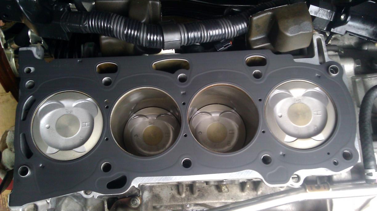

Installing the head tonight, gotta set the timing and hopefully put the timing cover back on

Cool! Looks like there won't be any clearance issues with the valves as some said here, I talked to jimmyjun and he said these would give about 171whp on stock ecu ect. I just want to see if these make the engine knock at WOT on 91

Yeah jimmyjun told me there would be no clearance issues either. Well my dumbass didn't get head bolts yet so I can't bolt the head down and set the timing until tomorrow
