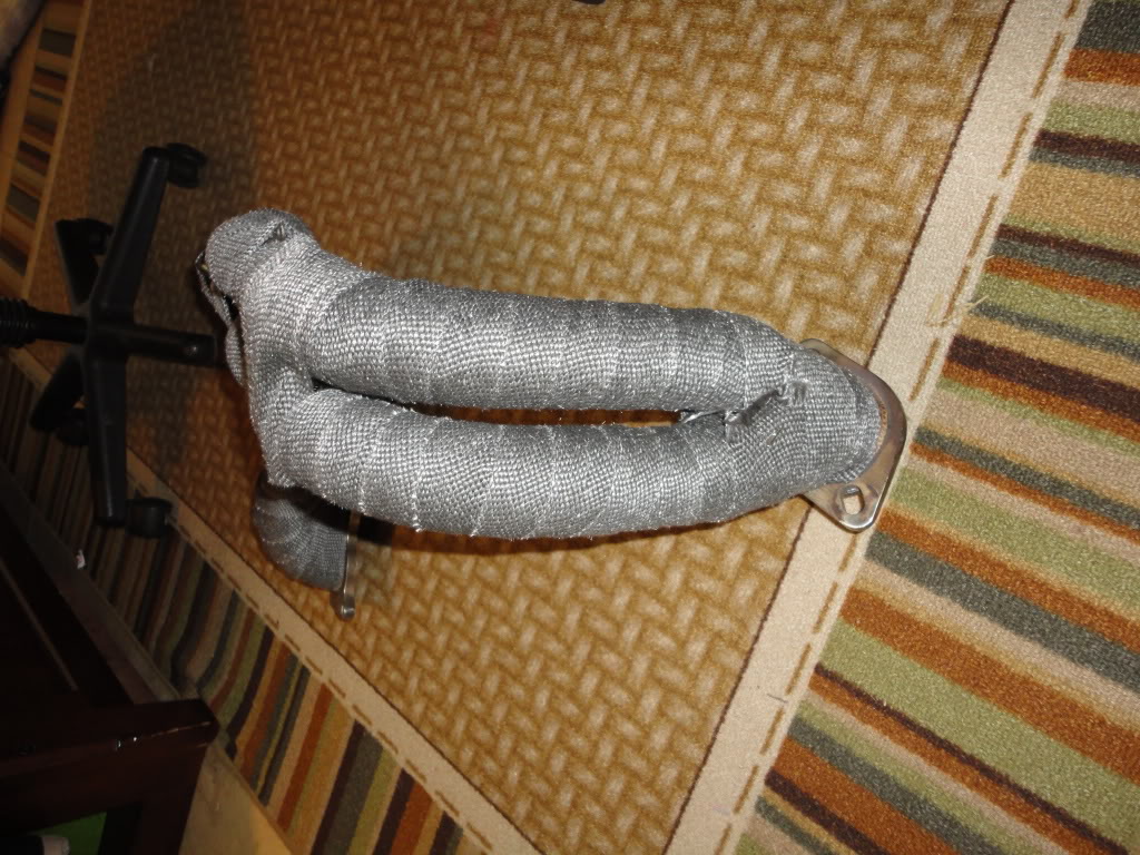

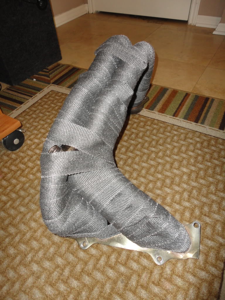

Thats my wrap. I know its not too good looking but thats why im looking for some tips on how to do this. Thanks for yalls help
Old Jun 30, 2011 | 11:35 PM
rangerryda's Avatar
Joined: May 2009
Posts: 2,251
From: Melbourne, FL
As long as you're happy with how it looks and it doesn't start to fall off, the routing looks OK. I'm picky and a perfectionist which sometimes leads to unnecessary methods of doing things. If you have to cut it to get it to look like what you want, then cut it. Just be sure that every free end has a metal tie to secure it in place so it doesn't unravel or loosen up. If at all possible, wrap each pipe individually but if there isn't enough clearance (which is the case more than not) then two is OK. I wouldn't go anymore than that personally.
