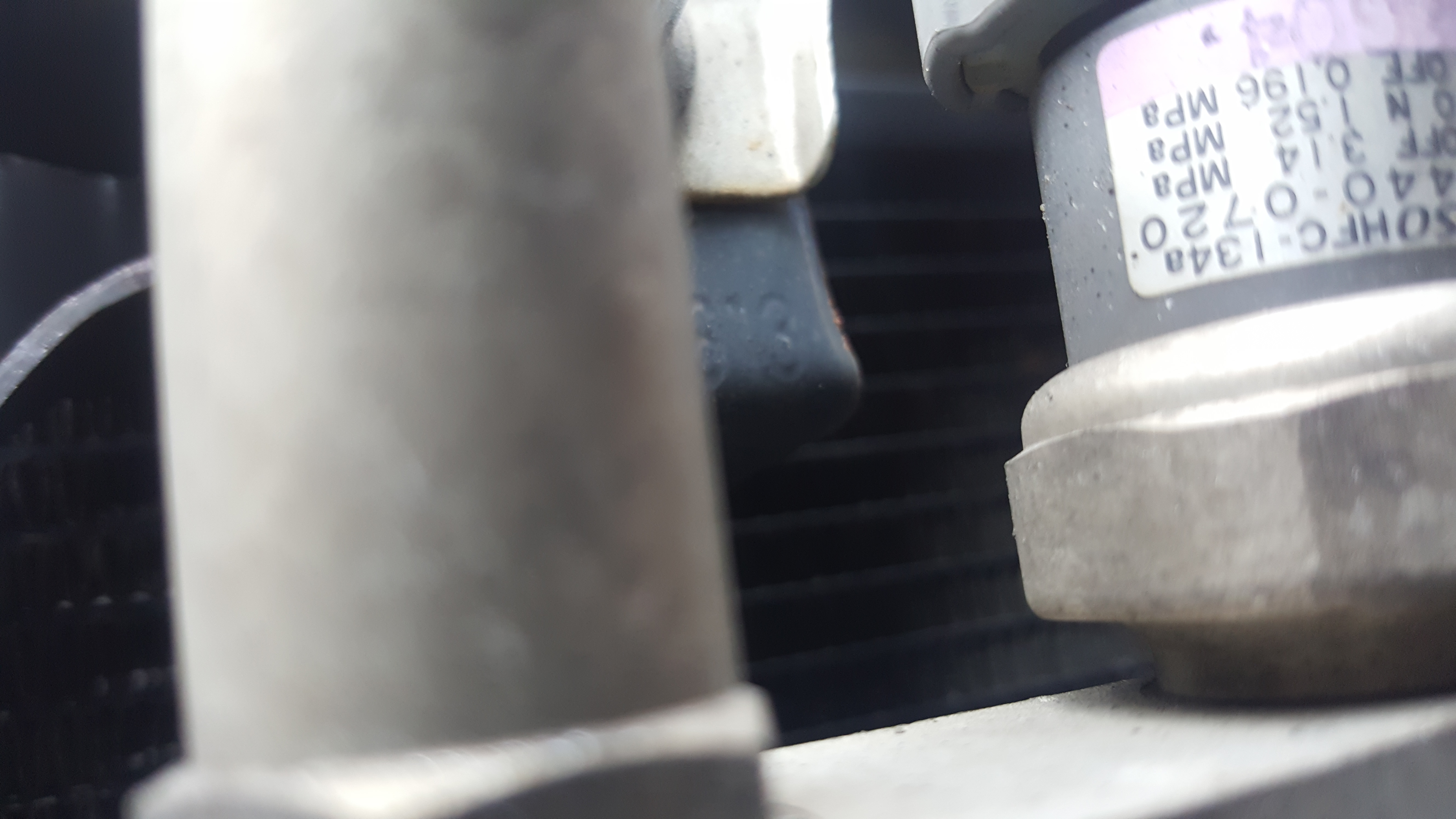

Can someone with a 2008 tC verify the part number of the air conditioner refrigerant pressure switch. Mine is kind of worn and I cant see all the numbers. attachment shows location. Part number should be on the side.
Cant find just this switch on Toyota part sites, have to buy the whole liquid line which I am trying to avoid. Thought I could search for the denso part number and get lucky.

all I can get is 4434....then 50 on the end. missing numbers in the middle. can anyone throw a look?

Yea, I could only find it with the line, but that was using the line part number from the scion part microfiche. If the switch part number is 443440-0050, which I suspect it is but would like verification, it is available new or used as a separate part.
Haven't physically checked you pull its, but have seen used parts websites that only sell the entire line.
You still have your tC? Can you verify the part number, probably did not change between 2006 - 2008. Thanks

Here you go bud.
Attached Thumbnails AC refrigerent pressure switch part number-20161210_125010.jpg   AC refrigerent pressure switch part number-20161210_124956.jpg

Cool Thanks. Yea, the switch alone can be had on ebay, new for about $38.00.
Turns out though it wasn't the switch, rather low pressure behind it. Glad I checked that before breaking into the system. Must be a very small leak cause there was pressure, but just below what is required to activate the switch. About 3-4 seconds after putting in the Freon the switch activated and the clutch engaged and VOILA!!!
