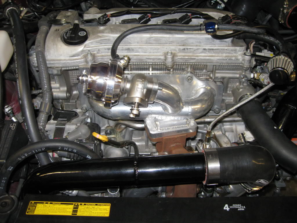

Old Jul 7, 2009 | 12:00 AM
crush02342002's Avatar
Posts: 11,271
just before turbo install (best pic i have of the filter)

Old Jul 7, 2009 | 01:18 AM
scuds03's Avatar
Posts: 222
From: n/a
You only really need a catch can if you are running boost. But if your NA and want one to have another pretty hing under the hood it wont hurt anything like the filter will.
