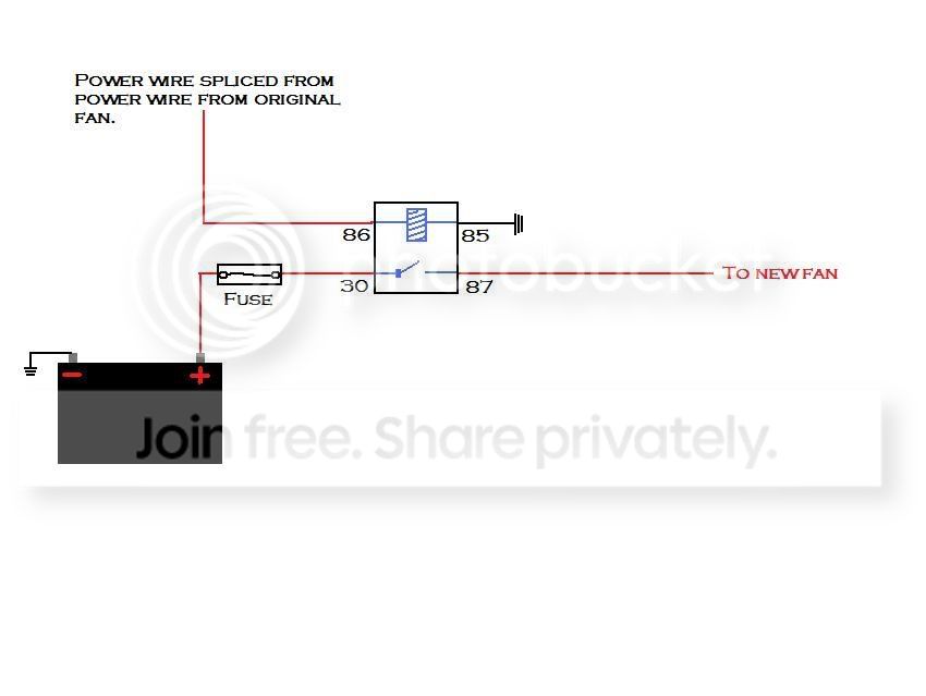

here ya go, hope this helps!!

that's so much better, thanks.. question though, why do I have to wire the new relay to the existing fan's power wire?

use a but splicecut the power wire on the old fan, strip each end add a wire going to the relay, ill make a pic for ya in a bit, got to go into town.

yeah but why do I have to tap the power wire of the existing fan when it already have its own power from the stock wiring and relay? isnt that supposed to be tapped on a wire that goes to the thermostat so it will know when to turn on or off?

well, you could tap into the thermostat wire to, depends on what you want to do. I would use the smaller fans power wire cause its next to the other fan, your already working there, and...maybe i think to hard, lol.
as for going on and off, when the thermostat would turn power on to the smaller fan, youd get power to the relay as well, which would close the contacts and allow power from another 12V source to go to your bigger fan.
