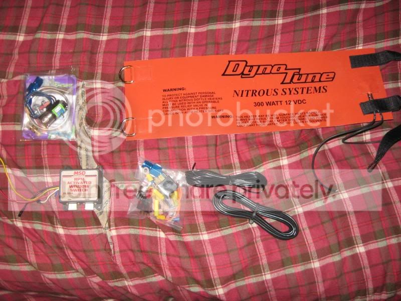

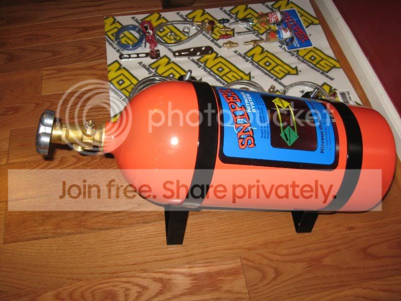

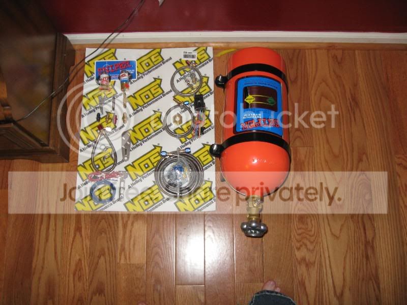

Im running a pretty budget full kit lol
I got the basic WOT controlled NOS sniper kit 75 shot -319
MSD Window Switch-65
Ny-trex purge-65
Dynotune pressure bottle warmer-99
blowdown tube-26
thats all ive got and an hour of dyno tune
