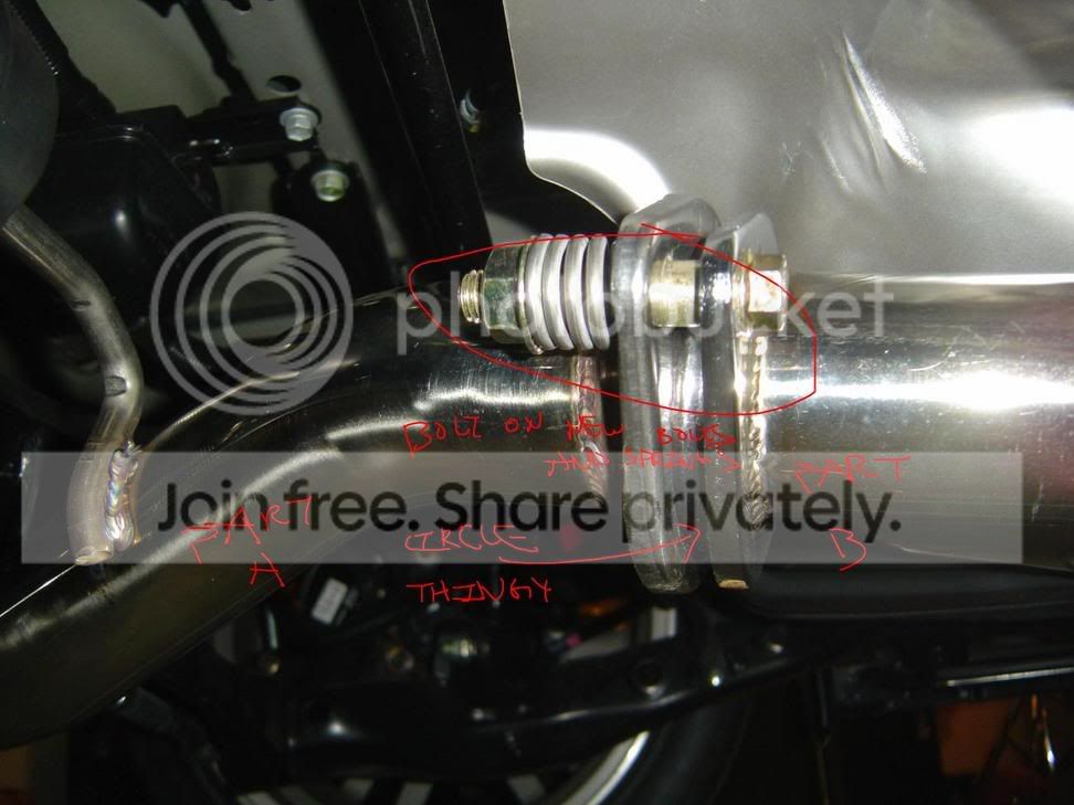

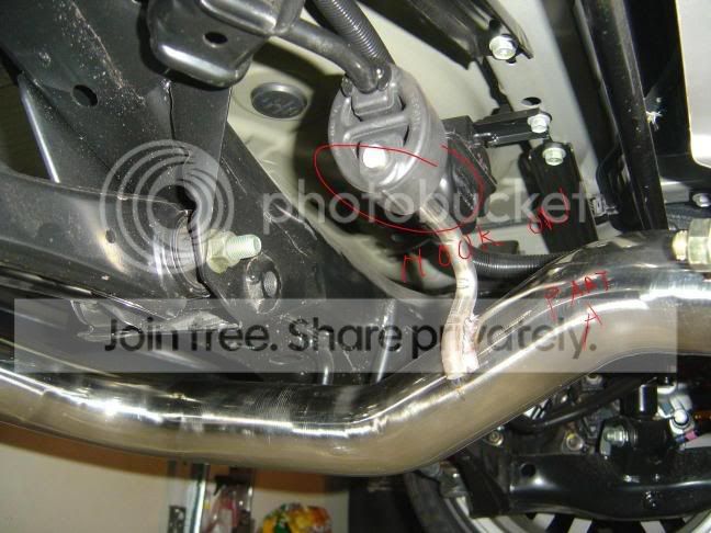

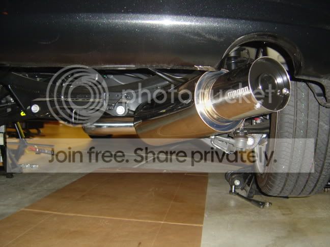

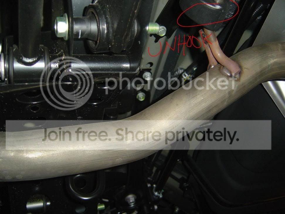

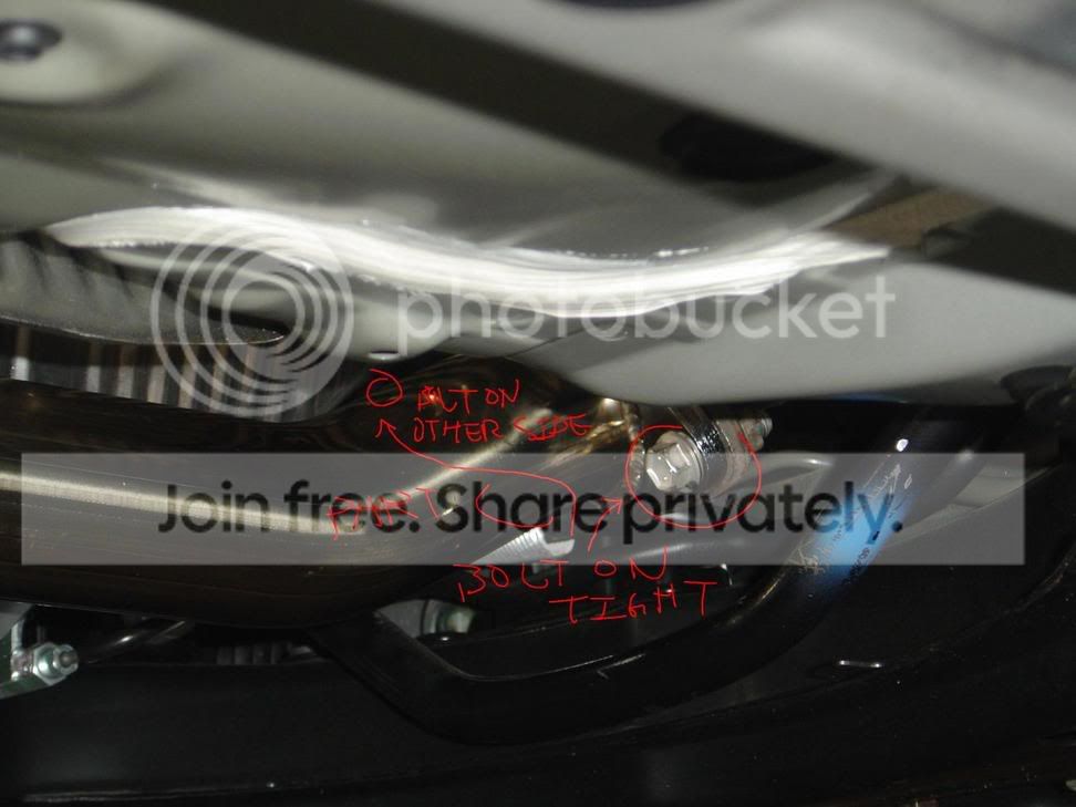

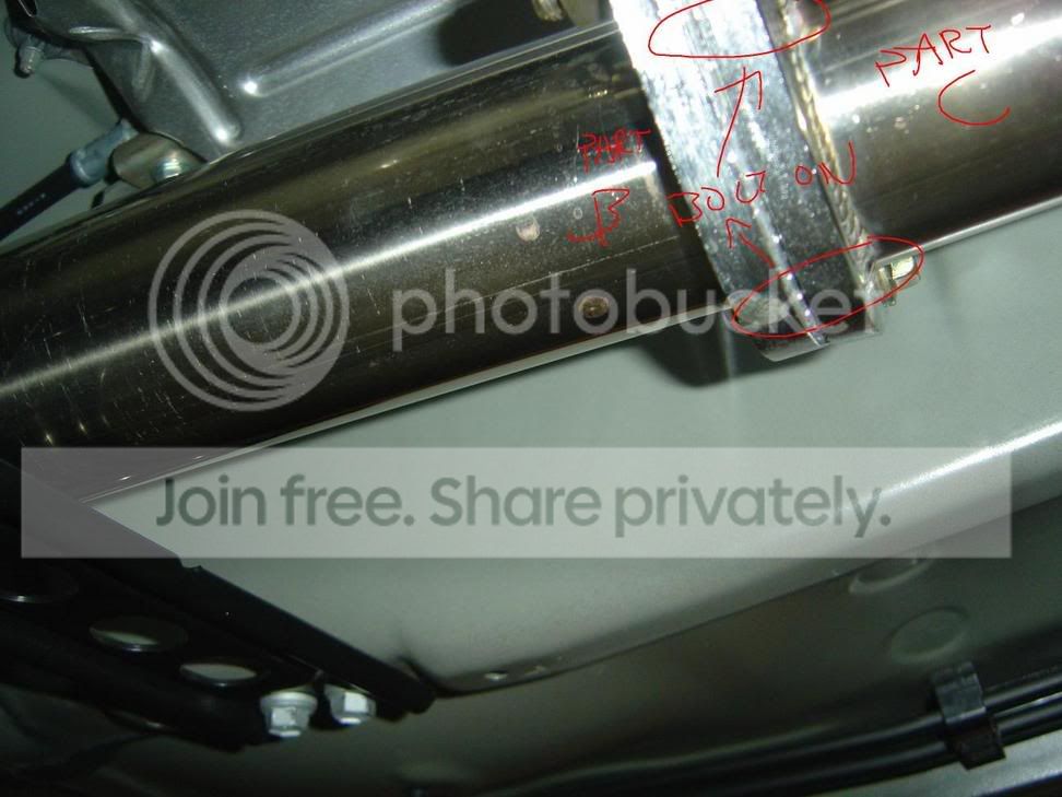

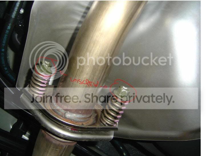

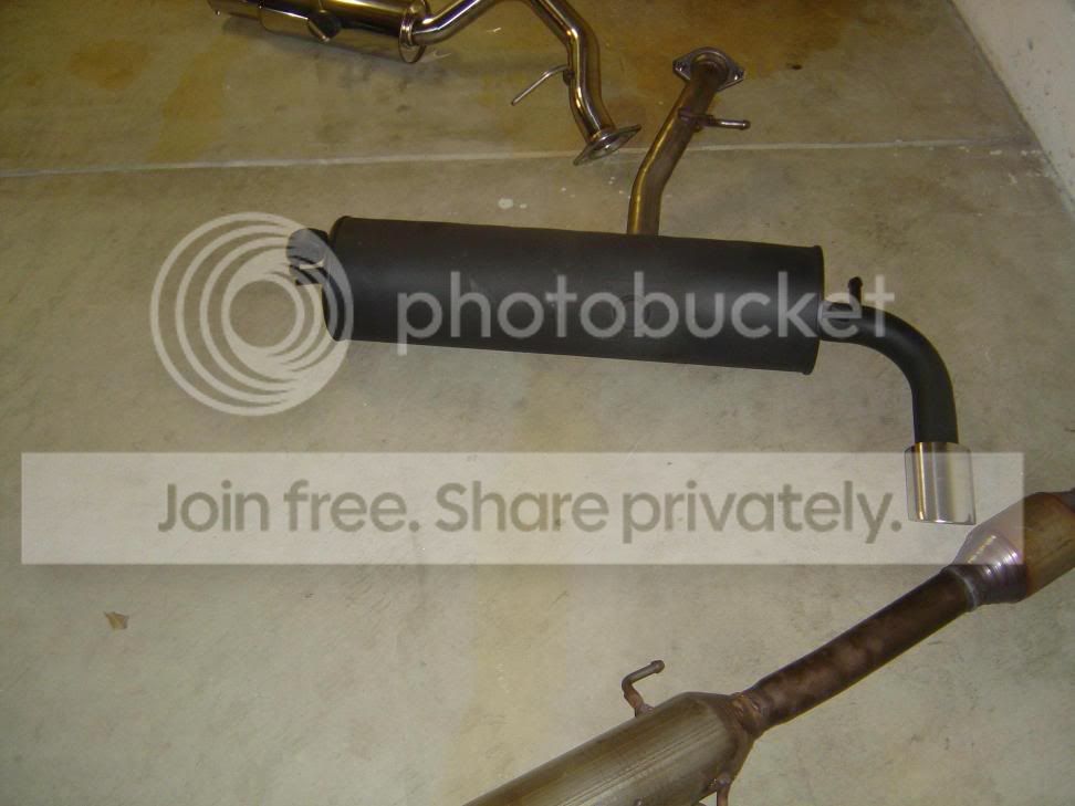

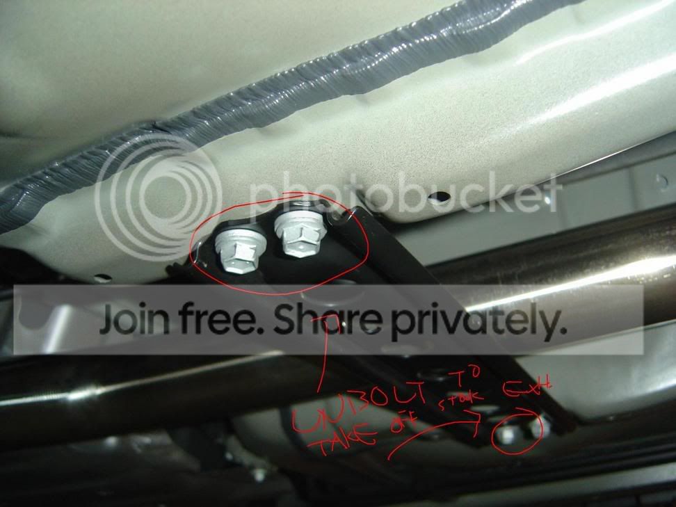

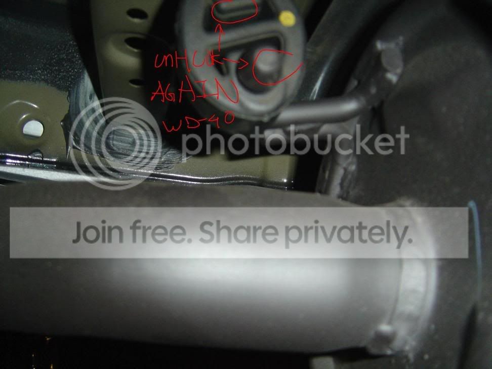

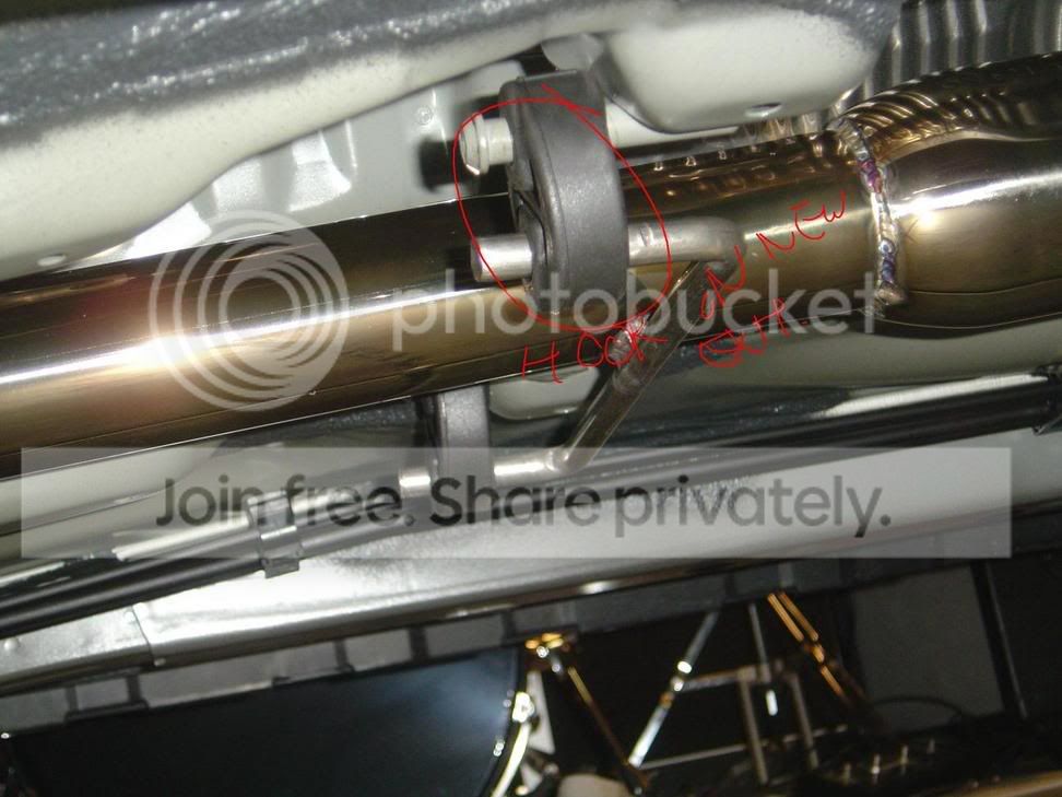

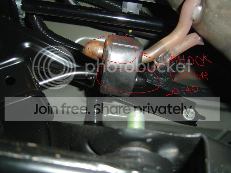

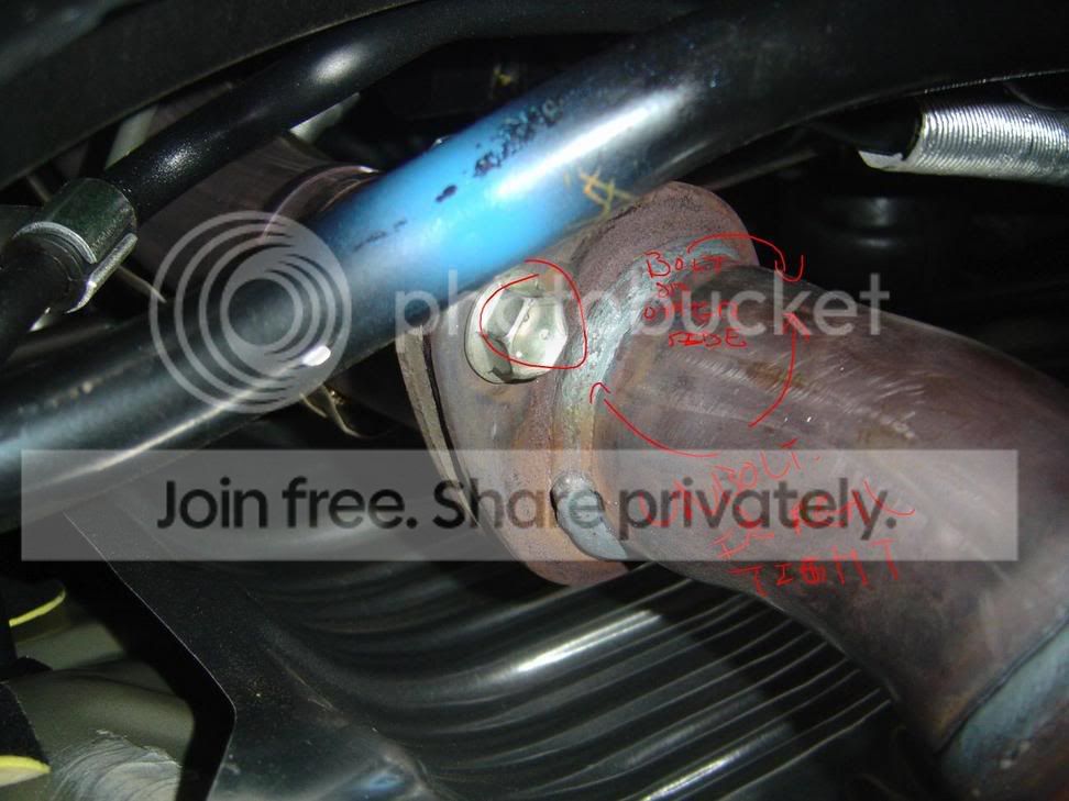

hope this helps..
step 1 -
step 2 -
step 3 -
step 4 -
step 5 -
step 6 -
THIS BOLT IS REALLLLLY TIGHT! AN AIR GUN MIGHT BE NECESSARY!!!
step 7 -
Don't forget to put it back on later!!
step 8 -
step 9 -
step10-
step11-
step12-
step13-
step14-
what do you think?[/b]

I think that's one of the funniest DIY's I've ever seen. Not to sound insulting though, I mean funny in a good way.
The little drawings and stuff like "circle thingy" were just entertaining.
Good job though...

fantastic walk thru.. does that mean you have no cat now? cause on the megan pipe'n thats just a REsonatoR lol be aware of CEL hah

you'll love the sound redline_tc.. It has barely any rasp to it and gives you that low rumbleing sound. I love it, and i hope you'll love it as much as mine when you get yours.

hey guys i'm going to be putting my exhaust on, and i bought it used and it didn't come with the nuts for the axle back system. Can anyone tell me the exact size of the nuts used? I would just go to the hardware store, but i don't want to have to bring my exhaust up there, i'd rather just go to the store and buy them and get it done in one shot. BTW that Megan system looks great on the Mica car!
Thanks guys **Jess**
don't mean to hijack your thread!
this nut here

did it come with any of the bolts? either way u should be able to use the stock bolts that u take off. i actually used 2 because they seemed to fit better than the bolts provided by megan

i was under the car and it looks like the bolts and springs come out but the nuts are welded to the stock axle back part. So i'll need to buy the nuts from the store, just wondering if anyone knew the size. Thanks guys **Jess**

I dont remember what size they were, Im sure you can take the bolt to the hardware store and find a matching nut.

It's all done and sounds great!!!!! not too loud, but louder than the TRD system. Thanks to all of you who helped me out. I am now done hijacking your thread!
