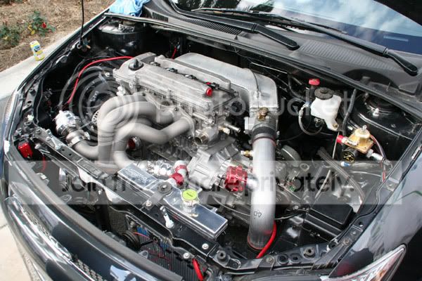

Originally Posted by engifineer
If someone reached that speed in 1/4 mile with a tC, they were about as stock as a race car
And you'd be correct (I believe this is the same car):
This car was at the SE Kick-Off at FIVEAxis the beginning of this year. It's been stripped down, and obviously there has been a little bit of work done to the engine.

the thread is called " FINALLY! a quick Turbo'd TC/Street Car" here is the link the thread
https://www.scionlife.com/forums/vie...3dc6b6dabe7579
here is the list of the mods
05 Scion tC
2AZFE
Head: Portflow Design
Valvetrain : Ferrera
Cams : Web Cam
Scion -Parts.com: Cam Sprockets
Scion -Parts.com: Custom Intake Manifold
Throttle Body : BBK 75mm
Fuel Rail: Emerg Auto
Head Gasket: Cometic
Head & Main Studs: A1
Block: ERL Performance
Pistons: CP Pistons - Stock Compression & 88.5 bore
Rods: Cunningham
Crank: Stock Lightened - Lopez Cranks Shafts
Transmission: Stock
Quaife: Limited Slip Differential
Turbo Manifold: Full - Race Engineering
Turbo: Garrett Turbo GT4088R
Wastegate : Twin TIAL 44mm
BOV: TIAL
Intercooler: HKS
EMS: AEM
Ignition: AEM CDI
Suspension: Progress Coilovers
Brakes: Powerslot Rotors
Tires: TOYO 25 X 9 x 15
Wheels: Motegi Racing
