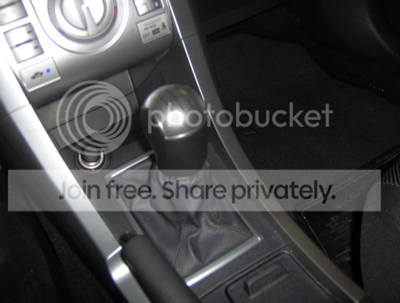

Doc I's gearswitcher is definatly one of my favorite mods that I've done. I got a 2" height reduction and love it and the cable bushings are completely worth it, they make a huge difference. Heres a crappy pic of my shifter:

Doc I's short shifter ftw! Probably still one of my favorite mods. Here's a crappy pic of mine also to give you an idea. 2" reduction seems to be the most common...
