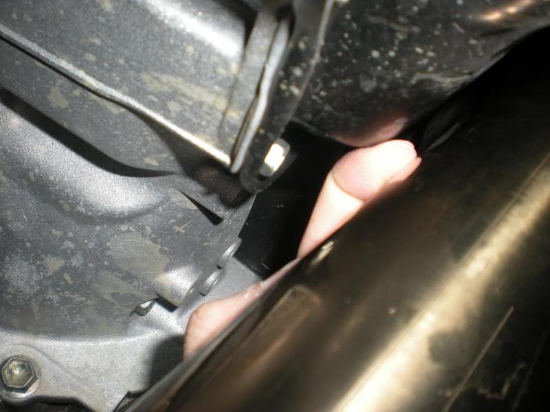

Yeah, if its hitting the pan theres something way off with the alignment and you should just weld it together. something has to be way off if its hitting the pan, it should be clear of it by atleast 1.5in.
Third time putting the pipe back on and same clearance. Does anyone else have a picture like this one of theirs?

ok so i FINALLY got around to putting washers on the bolts to see if that helps but as usual it didnt....
i think it's cause i put too many washers, i dont know... when ever i have free time, im going to a muffler shop to have them re-weld a new flange... but eitherway i took some pics for anyone whos interested... sorry for the crappy cell phone pics...
the washers i used:
tools i used: 14mm socket/deep socket, pry bar (to get the wrench out), 14mm wrench, extension bar, 3/4 and 1/2 rachets, and a creeper since im lazy lol:
i put two washers on each end of the bolt:
this is how it currently looks installed:
this is the flange im talking about if you dont know (s-pipe to midpipe flange) yea i know those are some sloppy ___ welds from a crappy muffler shop and no the exhaust leak isn't coming from there. i've checked it thousands of times:
and for those who wanted pics of my header to s-pipe flange with the washers i used to seal the leak:
hope the pics aren't too big!
