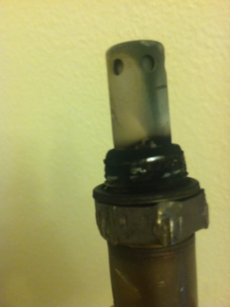

Oh I got it out, lol It looks like it was majorly mis-threaded even though I know it went in smooth, felt like it was welded in there and all the threads are abnormal, I have it jammed in the 4-1 where I wanna leave it cause it probably wont go back in again if I take it out. And of course that means I can't try the old one in the stock header because I would chance messing up the threads in the header>>> im not buying another stock header lol.
I probably did touch the end of it at some point, didnt know that mattered. But it worked fine for awhile, it hasn't been removed since new and I used anti-seize to prevent anything from happening again. I touch the secondary every time I swap it and it always ran fine after I "touched" it. Touched honda ones too. But hey, if that's the only thing it could be, then I might be getting a replacement, then my car will run good?? Hopefully.And just to be sure, you can't clean an O2 sensor right?? that will screw it up

I think the header is a harder metal then the O2 so the O2 will get messed up over the threads getting F99999 on my header by doing this.
This is what I was saying about the threads being messed up, the oher side is worse.

Yeah those threads definitely looks nasty. You might want to get a tap set and see if you can clean em up. If the threads get too messed up on the exhaust manifold you either have to find a new part or a good welder. Update when you've tested the original o2 and stock header combo, we should be able to narrow down the cause of the problem then.
So yeah, after basically jamming the crappy o2 in the stock header. It works perfectly as should even after 150+ miles. So I ruined a brand new AFR sensor by sucking water with CAI and no fender wells cause i'm low EVERYONE TAKE NOTE OF THAT IF YOU ARE RIDING THE SAME SETUP,, ,if its bad rain, pull over... please.
