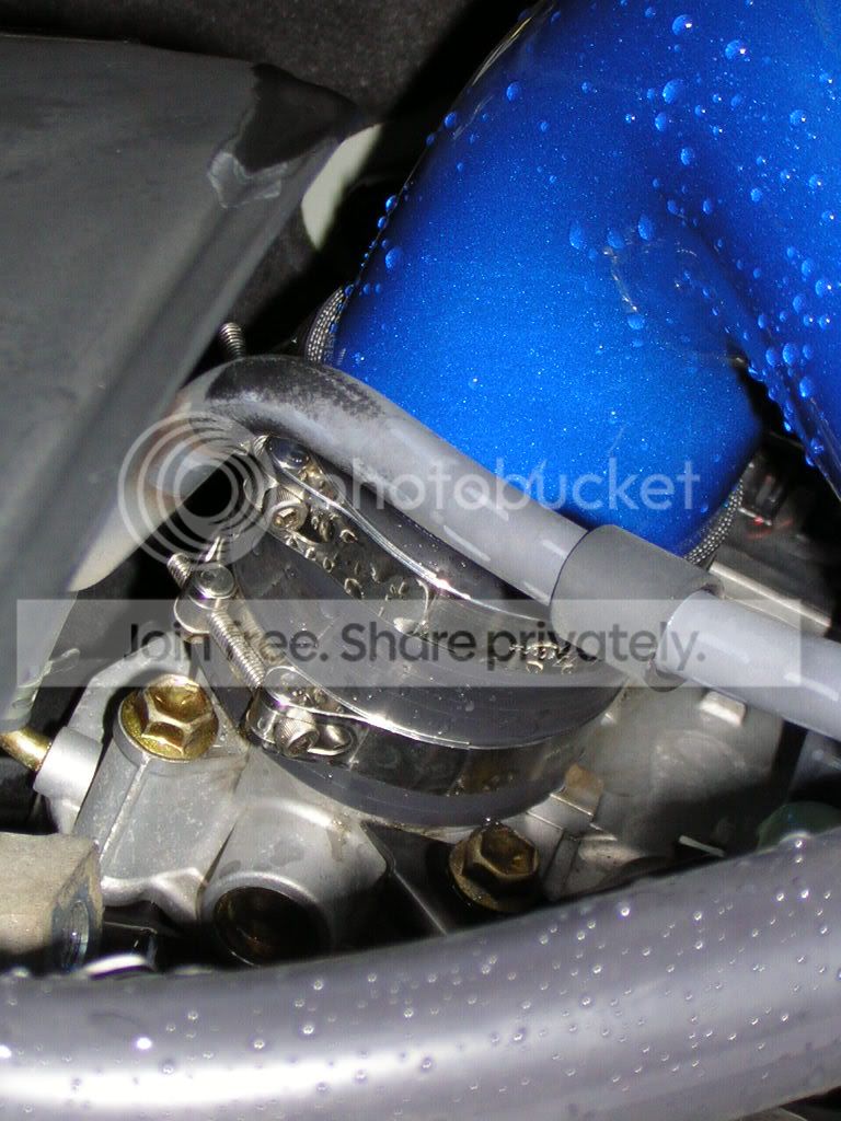

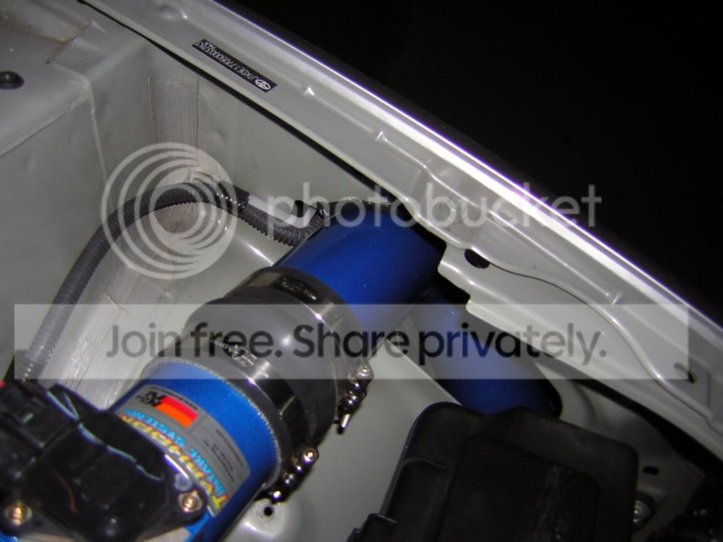

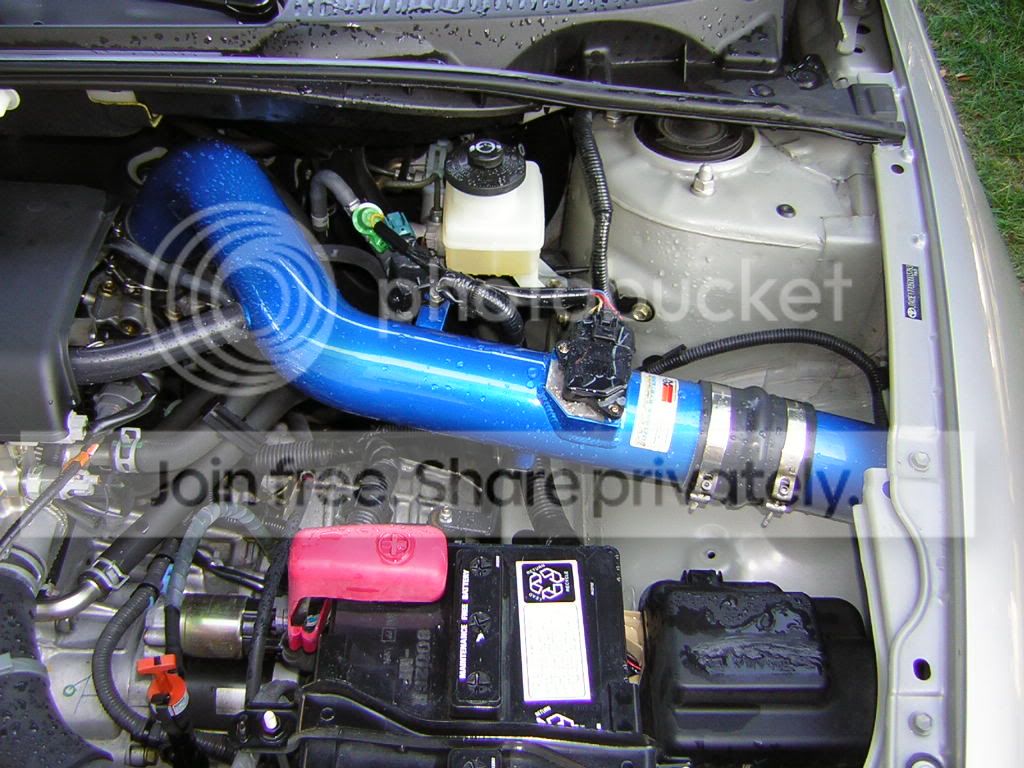

Here are some photos:
(The 1st photo was taken this evening after installing some "protection".)
(The last two were taken Sunday after I hosed off my engine area.)
Look closely and you'll see the fuel line hose protecting the intake pipe going into the wheel well: (see 400amonth's post above, too)
At the carburetor intake:
Installed and ready to rumble.... errr, roll!
