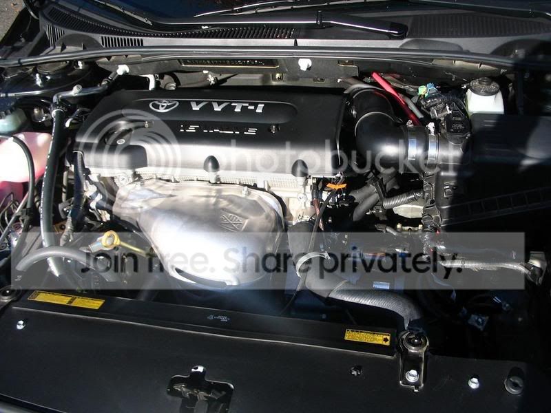

I just finished up the GFI (ghetto fabulous intake), idea courtesy of Dr. Isotope. I had ordered the parts the day before yesterday and it arrived yesterday (one day shipping if you order before 2 pm). I began the install first by roughly putting together the pieces, with the brackets loosened up for fitment. I took it down to the garage and began to fit it.
The hardest part of this install was the fitment of the piping, because you have 2 sections of the piping where you need to adjust the angles and also playing the rubber couplings for tight fitment. After I had it fit, i tightened the brackets and took it back out to drill the hole for the nipple.
i had noticed that no matter how you adjust the nipple hose, it would sit slanted at an angle, thus making it susceptible to leakeage. i saw that the opening from the engine is right across the piping, so, i drilled the hole on the 90 degree elbow, and cut the existing hose to make it fit. it fit perfect.
i rechecked everything and tightened it up. took it out for a drive. nothing too noticeable. the sound was deeper, and seemed (SEEMED) to perform a tad bit better.
very nice mod for about $50.

I've had mine done for almost a year. Here's a pic of what it looks like anyway for those who were wondering. Mine is painted flat black and I didn't have any problems with installing the nipple.
