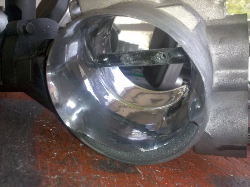

How's it goin guys. A buddy of mine ports throttle bodies for mainly american cars, 5.7/6.1L hemis etc etc. Anyway he came up to me and asked me how the Scion community was and if anyone would be interested in having throttle bodies ported. I explained to him how the sponsored sales department works here etc etc so This is not a sales thread, I'm just gauging interest for him to see if anyone would be interested in having throttle bodies ported and if it's something he could invest into. He took a look at my throttle body and he said he'd probably be doing like 30-40 dollars shipped for the work. So you'd just send in a tb and he'd port it and send it back out. Anyway here's an example of what he does, he goes from this:
to this:
The pics above are a stock 5.7/6.1 Hemi and a ported one he was working on today. It isn't 100% finished as I snapped the pic while he was polishing it and hadn't worked on the blade yet, but you get the general idea. He ports by hand, not CNC. He also does intake manifolds, and heads on request, but mostly does TBs.
What he does is he enlarges and re-finishes both sides of the throttle body, tapering it in the center for the stock TB blade. The stock blade is knife-edged for better throttle response.
Guy really does great work from what I've seen and he said that he hasn't gotten a single complaint from his previous customers. Apparently he's had reports of fuel economy increasing by rough about 1 mpg and some performance improvement aswell, however he hasn't had any dyno proof (one of his customers with a Gtech reported a .2 reduction in 0-60) just what his customers have told him.

Hi everybody, my name is Ryan , I run an outfit called Flyin' Ryan Performance. I deal with primarily late-model Mopars (that's Dodge/Jeep/Chrysler stuff for you JDM types :D ) . I am the guy that Konrad aka A german named hans speaks about.
As a way of paying my bills and providing myself with a little supplemental cash, I do hand-porting and polishing. I almost exclusively deal with throttle bodies, but will do intake manifolds and headwork if you ask me nicely. I have 100% feedback on Ebay and Jeepgarage.org (where the majority of my business stems from) . I dont have the same precision as a CNC but I do try my best to make nice stuff.

No, it does not. The way I do it, I enlarge the inlet and the backside as far as I am willing to take it, then taper it in to the size of the butterfly. I don't offer various sizes or anything like that, it is a one-size fits all sorta deal.
What I have found through customer feedback as well as my own testing is that enlarging the inlet, port-matching the backside to the inlet of the intake manifold, all the while retaining a modified OEM blade creates crisp throttle response. I suppose it could be argued that it creates a venturi like effect by forcing the air through a slightly smaller passage (the blade diameter). A customer of mine took a early FRP TB (the first few TBs I did were not nearly as clean and smooth as they come out now) and a professionally done TB with a larger blade and all, and by the seat of the pants no difference could be determined.
40 shipped seems reasonable, based on looking at Konrad's TB.

Heres another pic of a throttle body I was working on this weekend. This one hadn't yet been cleaned and re-assembled, but it's a better picture of what I actually do.
The final product ends up slightly more polished than it is here...There was still some remnants of buffing compound on this one.

My only concern would be fuel delivery. These ECUs are great and VERY accurate at calculating air flow of the air entering the system. Part of the equations which the stock ECU uses to calculate delivery of fuel is based upon that stock TB size. So if it's increased, it will cause a leaner AFR, which can produce power, but also make it more sensitive to knock. Has this been tested for safety? I am in no way knocking your deal, just making people aware that they may need to retune to use this item.
Also, how is idle?

I looked at your site and you appear to be quite knowledgeable, so allow me to pick your brain.
It appears that the TCs use a MAF system as part of their fuel/spark management. I'm used to dealing with MAP systems. So I assume that the MAF "expects" a certain air mass correlating to a throttle percentage and rpm?
how does the stock ECU calibration react to bolt-on modifications such as CAI's, full exhaust, etc etc.?
My theory is this: At part throttle where the ECU should be in closed loop, even if there is more air coming through (which there will be), the ECU should have the ability to add whatever fuel is needed to correct to that 14.7:1 AFR. Not knowing anything about what the stock ECU calibration is like in terms of WOT AFR, I dont know how it would change. I would presume it would be a few tenths leaner.
I dont think it would necessitate a re-tune, only because it doesn't appear that a retune is needed for other bolt-on modifications. Unless I am missing something??? The ECU doesn't freak out when there is a change to air density due to a change in the temperature or say, high altitude, so why would this be all that much different?
One area where I WOULD be concerned, is how the ECU would react to a TB that had a knife-edged blade. the knife edge allows even more air to pass the blade at a given throttle percentage in comparison to a already ported TB. So in theory the increase in air mass as you increased the TP% would "ramp up" faster than a stock blade. That might cause a problem with the ECU. It might freak out the cruise control, causing it to surge some.
On the MAP-based EFI Mopars I work on, Idle is not an issue once the ECU re-learns it. There has been one instance where there was surging and stalling, but it was a combination of not resetting the PCM and a particular model of the ECU that is very stubborn to re-learning. It eventually settled down.
